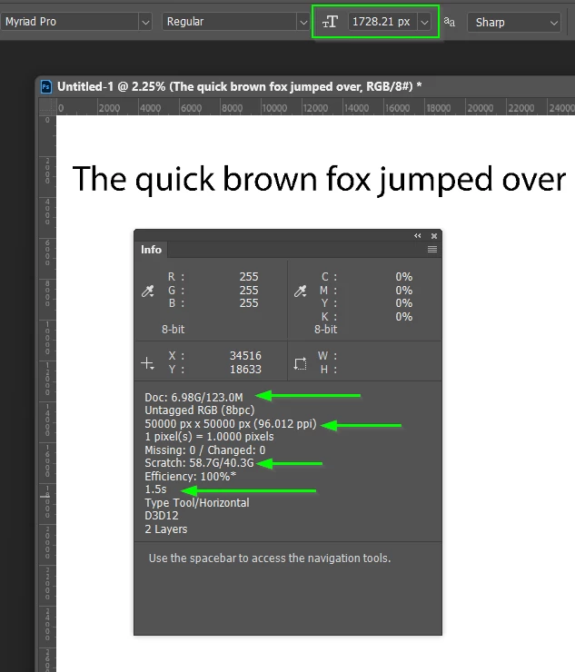

Sounds like something is very wrong there.
What is your document size in pixels?
What size is the text in pixels?
OK, none of that should matter.  I just tested with a 50K x 50K pixel image, and what turns out to be the maximum allowed font size of 1728 pixels (I didn't know there was a limit).  You can see it created 58GB scratch file, but the text appeared as quickly as I could type it, and there was no delay when I committed the text.

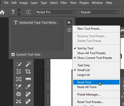

I'd go right ahead and reset the Text tool
Use drop down top left corner
click on the little cog icon
click on Reset Tool.
If that doesn't help, think about a full Preference reset.  If that doesn't help, tell us as much as you can about your situation.
