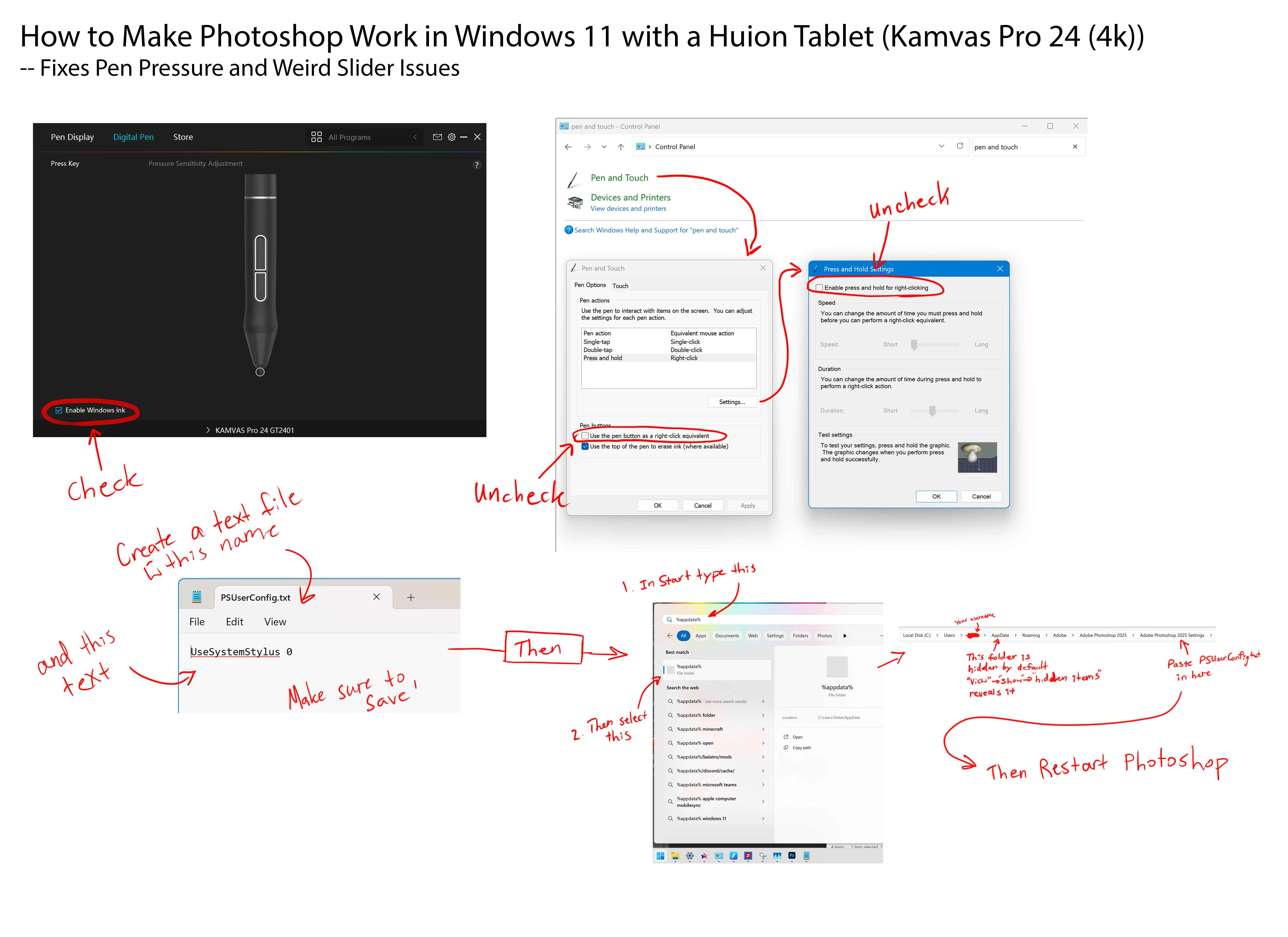

I found the solution for this in this forum post: https://community.adobe.com/t5/photoshop-ecosystem-discussions/photoshop-interface-lag-with-huion-drawing-tablet/m-p/12846066/page/2
I made a little sheet explaining the steps for it here:
defaultt0pxb05axykrCorrect answer
May 30, 2025
May 29, 2025
I've also encountered this issue with Windows 11 on a Huion Kamvas Pro 24. It's really annoying! It stops being an issue if you disable Windows Ink on the Huion Tablet Digital Pen settings but then you lose pressure sensitivity in photoshop.
Would love to find a solution for this.
