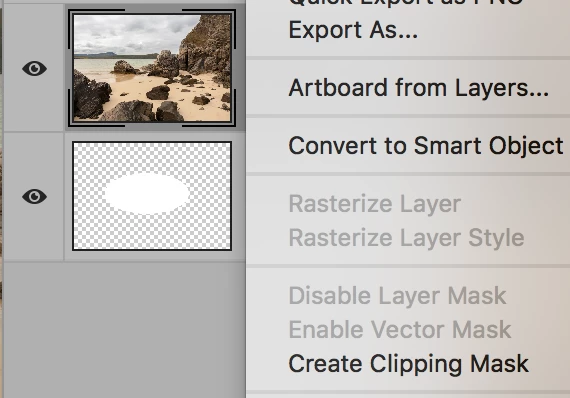

Step 2: Choose "Create Clipping Mask"
To create the clipping mask, go up to the Layer menu in the Menu Bar and choose Create Clipping Mask:
Selecting the Create Clipping Mask command from the Layer menu in Photoshop
Go to Layer > Create Clipping Mask.

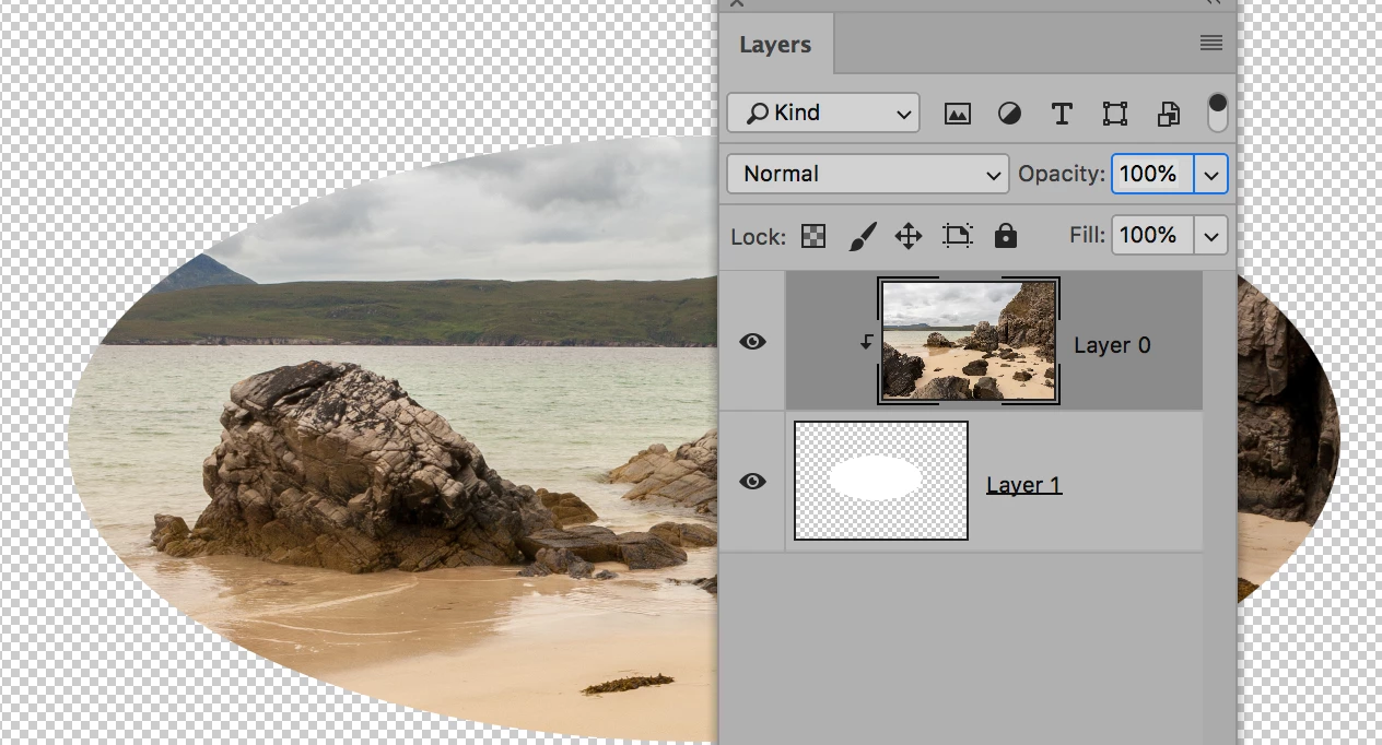

But in the document, we now see a very different result. This time, the section of the photo that's sitting directly above the shape on the layer below it remains visible! The only parts of the photo that are hidden are the areas surrounding the shape, since those areas are still sitting above transparency:
Photoshop clipping mask after adding content to the mask layer
The content on the bottom layer keeps part of the top layer visible.
Moving Content Within A Clipping Mask
Of course, the result might look better if our subject was centered inside the shape. With clipping masks, it's easy to move and reposition content within them. Just select the Move Tool from the Toolbar:
Selecting the Move Tool in Photoshop.
Selecting the Move Tool.
Then click on the photo and drag it into position. As you move the image, only the area that moves over the shape on the layer below it remains visible. And that's the basics of how clipping masks work:
How to create a clipping mask in Photoshop tutorial
The clipping mask after centering the photo within the shape.

there are several ways to get it. A simply method is:
- copy the image that you want to past in the circle
- draw a circular selection (elliptical marquee tool)
- past into a circle (Edit > Past special > past into)
Photoshop create a layer with a layer mask

Draw the circle on a new layer. Move it below the photo. Right-click the image layer and select Create Clipping Mask.
Photo credit to davescm​ on the SFTW photo challenge.

• Create a Shape Layer with the Ellipse Tool
• place the image above (either move the Layer there [to convert a Background Layer to a regular one double-click it] or use File > Place if you created a new file)
• Layer > Create Clipping Mask (cmd-alt-G)
