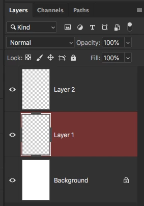

This just happened to me. In case anyone else finds this in a google search, I figured out I was in quick mask mode! Accidentally hit Q on the keyboard.
gener7
December 13, 2018
An easy way to know if a layer is in Quick Mask mode is to check the Layers Panel. If the Layer is displayed as red, Quickmask is active.

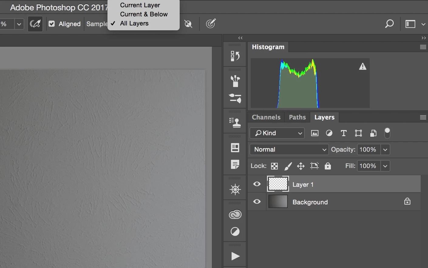

josephlavine
October 22, 2017
As other have already posted, you need to select either "all layers" or "current & below" to clone into a different layer.  Hopefully the attached screen capture helps.

sishamIAGD
July 28, 2014
Well 'Current & Below' if you want to copy the layer below onto a new layer :-)
gener7
July 28, 2014
Set the Tool to "Current Layer" in the Options bar at the top.
