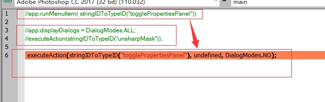

hi everybody,
     i  want to close the Properties panel,what method it please?
i know this script of runMenuItem can it ,but i need an ActionManager mode.How to transfer it?
app.runMenuItem(stringIDToTypeID("togglePropertiesPanel"))
This is wrong...

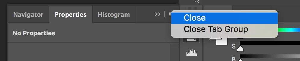

Using the GUI of the Properties panel to close...

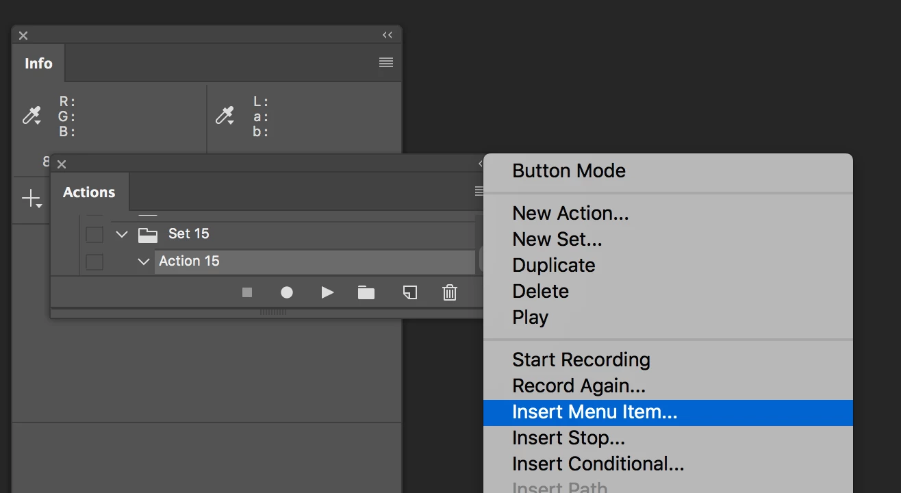

Or as an alternative:
  1. Have the properties panel open
  2. Clear the ScriptListener log
  3. Insert a menu item into an action to close the properties panel, you should get the following...
Both methods return the same SL code:

but the first method may be used ScriptListener.8li,Why can't I? how to "Insert a menu item into an action "?

I had the same SL output result by the following two methods:
1. Clear SL log file
2. Use the Properties panel menu item “close”
or
2. In an action, use the Action panel menu item to “insert menu command” and then select the Properties panel menu item “close”:
For completeness, here is the xtools output of converting such an action to script:
