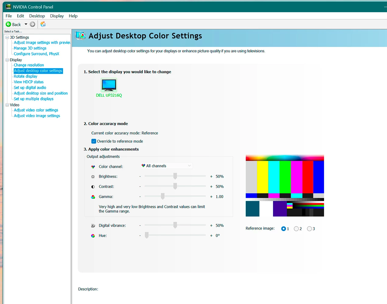

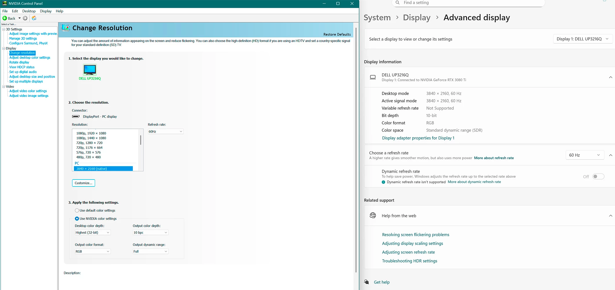

In Nvidia, I changed some settings in order to make sure the GPU driver does not intervene and alter the colors. The attached pictures show my current settings in the GPU driver as of now. Nevertheless, changing these settings did not make any visible difference in the color appearance of pictures in any application.
