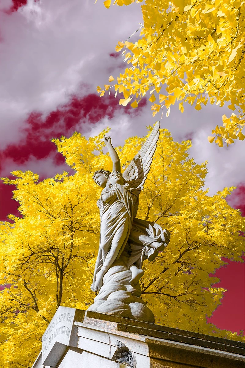

In the case of the attached photos, I was attempting to turn a blue sky red. As I adjust the hue of the blue slider, and it approaches the color red, the area where the yellow vegetation meets the sky, however, produces significant artifacts or fringing, detracting from the image quality. I can move the blue slider in the Hue/Saturation control approximately +20 or -50 before encountering this condition. Once I exceed the +20/-50 threshold, it appears that Photoshop neutralizes the pixels of the yellow vegetation. Thus no movement of any sliders of the Hue/Saturation control affects the color of the fringe areas.

  • The first image (angel and mausoleum) shows the full effect.  The lower right-hand corner is a good place to focus.
  • The Starting Point image (2nd image - 100% crop of the red vegetation and blue sky) reflects how an image appears at the beginning of the process (after a Channel Swap process). As you can see, the Starting Point image (2nd image - 100% crop of the red vegetation and blue sky) exhibits no fringing and there is a clear delineation between the colors.
  • The other image (3rd image - 100% crop of the yellow vegetation and pinkish-red sky) reflects my changes and the resultant fringing effect.

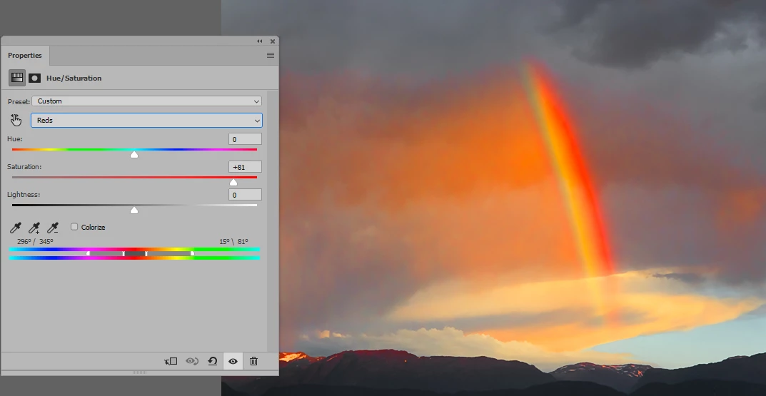

    This is what Hue/Sat does. I've always felt it's a bit flawed for this reason. It's very quickly done to break up the image in banding and blotches.
    Yes, you can split the sliders to taper the range off gradually - but neutral is still neutral and those pixels are never touched. There's always an abrupt threshold there. What's needed is an area/feathering control in addition to the hue/range controls.

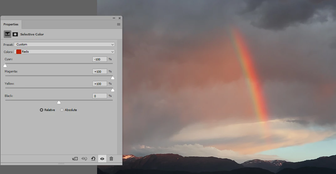

    I normally use Selective Color instead of Hue/Sat, at least for smaller corrections, because it works differently and never breaks image integrity. It doesn't have quite the potency, though:
    BTW - the hue/sat controls in ACR behave the same way, breaking up integrity, even on raw files.
