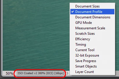

Before it's possible to say anything meaningful here, we need to know what the embedded CMYK profile is:
We also need to know what you have set up as your working RGB, because this will be used by Photoshop in calculating the numbers going between them.
What is most likely happening here is that you are picking RGB colors that are out of gamut in the CMYK color space.
