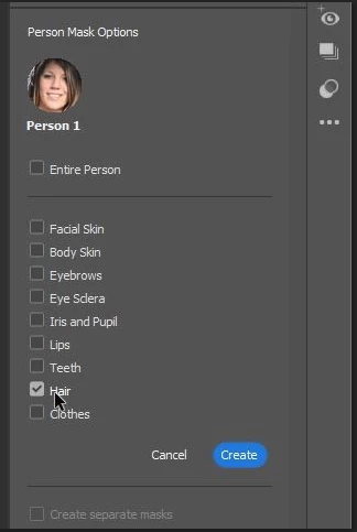

Another method I might suggest is to use Adobe Camera Raw, or the Camera Raw Filter in Photoshop-
1) Convert to B&W (One button click)
2) Use Masking to find "People" and create individual masks for  Hair and Lips,
3) make color changes with the Tone curve
