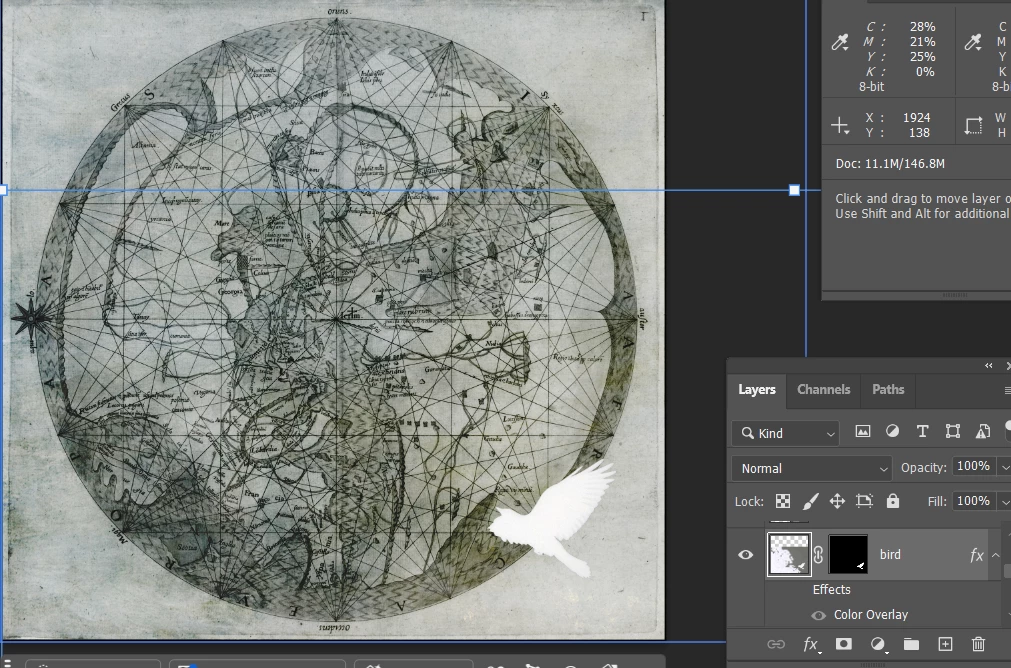

Hello, I inverted an image and tried putting in a color overlay to color it. Although that layer it lists a color overlay, the color did not change. How can I get the color overlay to work? Is there a better way to color in an inverted image?

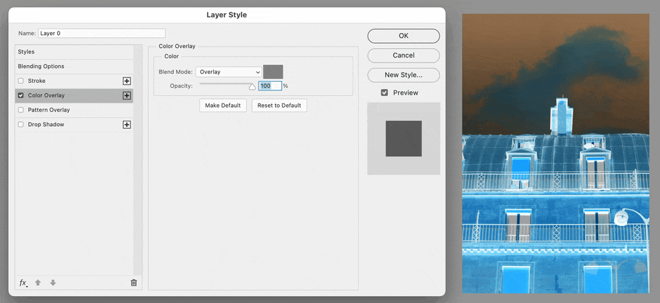

You’re using a Color Overlay layer style, right?
It should work as well as it does with a non-inverted image, but it depends on which color combined with which Blend Mode. Some combinations may produce no change.
What is the color value applied to the Color Overlay style?
What is the Blend Mode applied to the Color Overlay style?
If the Opacity of the Color Overlay style is less than 100%, what is it?
If you are specifically trying to “colorize” the entire image with a single color, then the Blend Mode should be Color.
These points are shown in the demo below. (Sorry for the bad color quality, the compressed GIF animation I uploaded looks smooth but the Adobe forum software degrades the color quality.)
Jan 9, 2026 9:19 PM UTC
Thank you for getting back to me.
The color value is R: 22, G:230, B: 232
The blend mode is Multiply
Opacity is at 100%
I tried changing the blend style, but the bird still ends up as white.

Jan 10, 2026 10:56 PM UTC
The first thing I notice is that in the screen shot that was attached, the Effects visibility (eye) icon for the “bird” layer is hidden, so Effects are disabled. Because Effects are disabled, the eye icon for the Color Overlay item is dimmed to indicate that Color Overlay isn’t visible right now. Does it work if you click the visibility column for the Effects item that I circled, to turn on that eye icon and make Effects visible for that layer?
