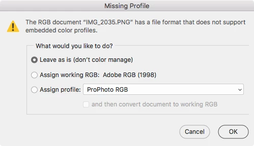

    The Apple iOS capture is not clear. If I turn on warnings in PS and open a iPhone capture, I get this, probably because PNG has a mixed history with color profiles?

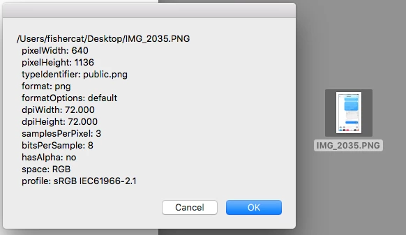

    If I run the capture on an ImageEvents AppleScript, it tells me the embedded profile is sRGB:
