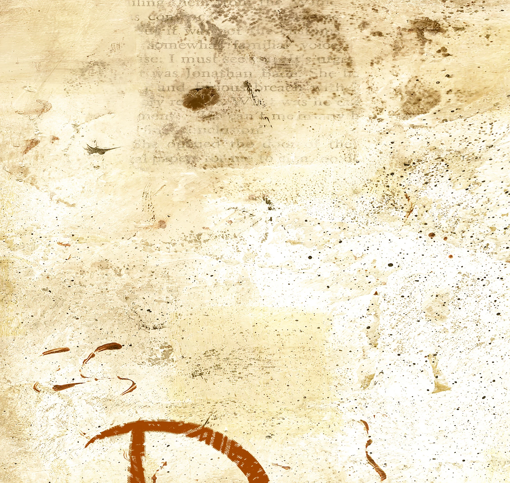

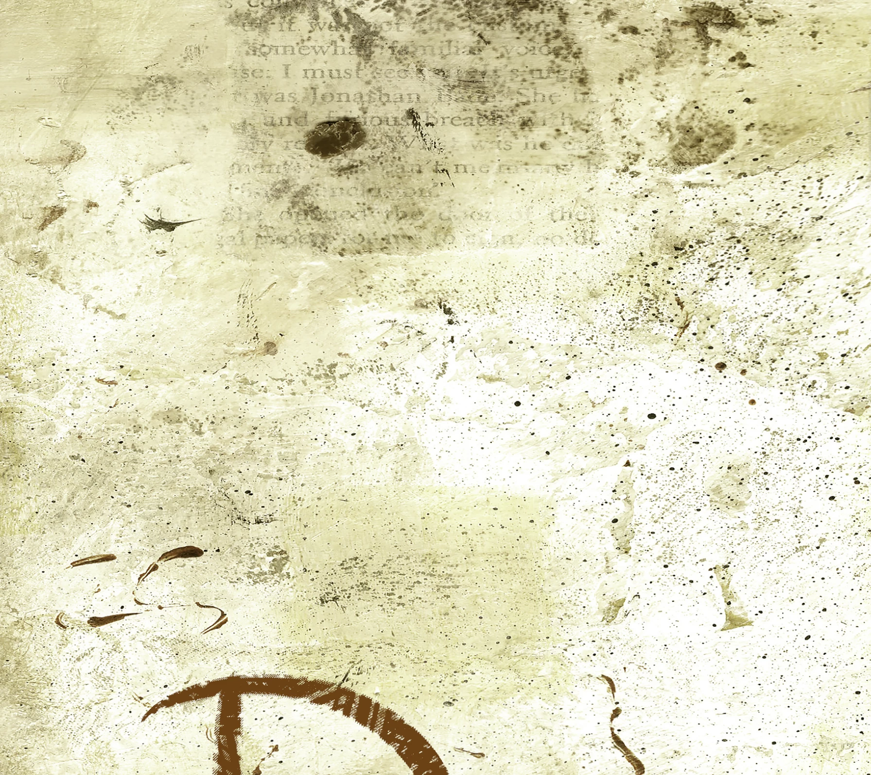

After editing in Photoshop,  go back to Lightroom Classic, there is a color shift, see screenshots below.
The same color shift is happening  when I go from Photoshop to Epson print Layout.
I'm working Photoshop 26, and RBG modus, Imac 14.6.1, Lightroom 14

The difference in your two screenshots is the difference between Display P3 and ProPhoto.
So my guess is that you have a ProPhoto file (which is the default from Lightroom Classic) - and displayed on a standard Mac P3 screen, without working color management. The most likely scenario is that one of your applications doesn't load the monitor profile correctly, and so the color management chain breaks. It could also be a file without an embedded profile at all.
