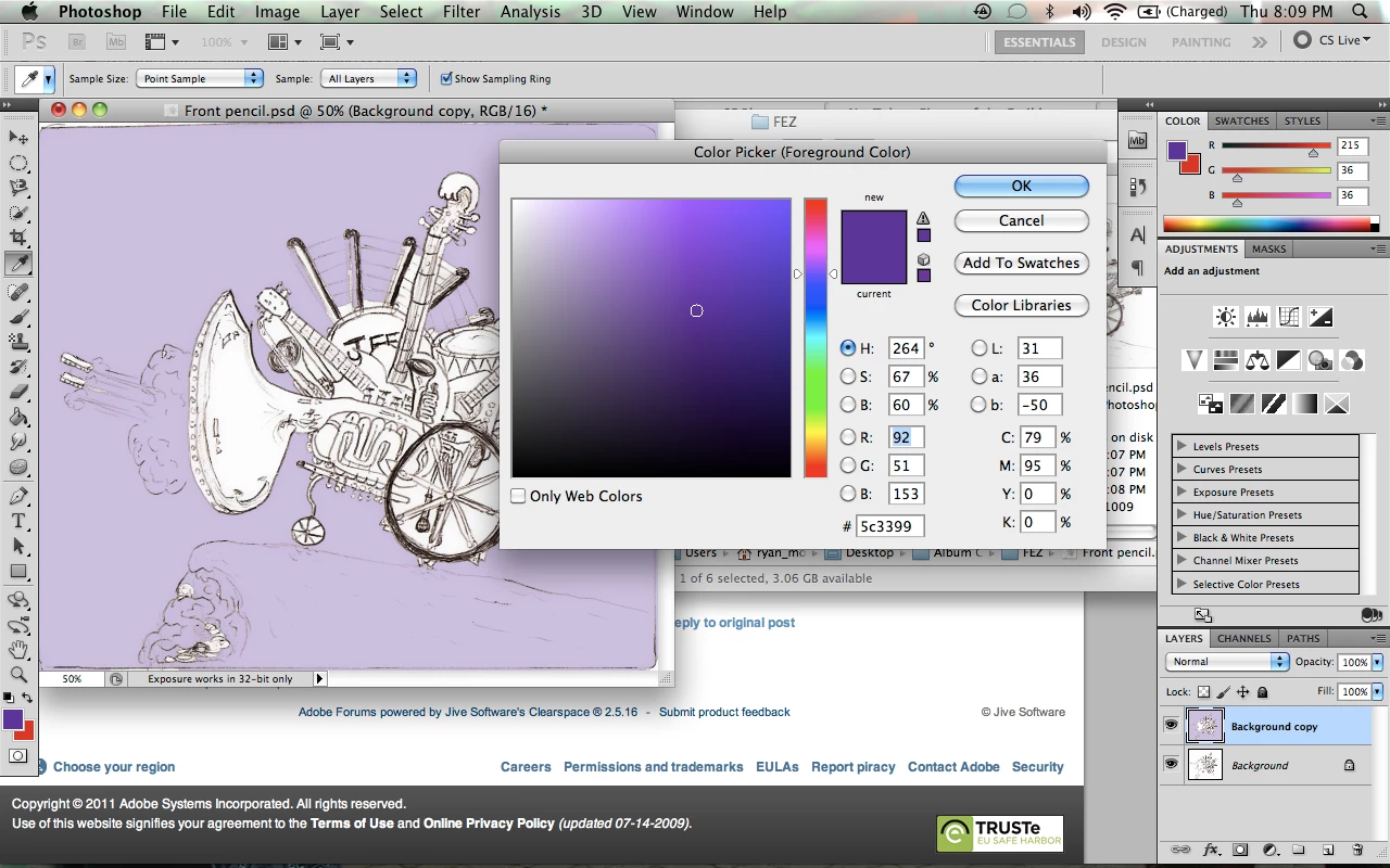

    I've been having the same problem, but mine definitely isn't coming from the adjustment tools. I scanned a drawing that I wanted to add colour to on the computer, and when i open that image with Photoshop and try to use colour I have the same problem (this is only the background layer, same thing happens if I make a duplicate layer). Would be great if someone could work out what the problem is
    c.pfaffenbichler
    March 31, 2011
    Could you post a (or several) screenshot/s to show what you are talking about?
    If you use painting tools what are your Blend Mode settings for those?
    March 31, 2011
    Here's a screenshot. You can clearly see the colour that I want to use, and the colour that it comes out as (the light purple in the image). I'm not sure what's wrong (I'm not very photoshop-savy in case you haven't already noticed haha)
