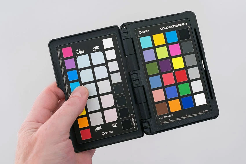

D Fosse
November 9, 2018
You need to use a color checker or similar, and always work with good icc profiles. This way you always have a numerical reference you can go back to.
Each patch has standardized Lab values. Normally you won't be able to match the color patches exactly, and that is never the goal anyway. But it will tell you if you're in the right neighborhood.
The six gray patches are more useful. Not only can they be used to set a basic contrast curve and brightness, but also check neutral color balance from highlights to shadows.
Digital cameras will normally get you there just by setting the white balance, and the colors will basically be right. Film and scanners are much more uncertain. If you shoot film, include a colorchecker in a test shot, and above all, get a good scanner profile.
Much can be said for film, but in terms of predictable and accurate color, digital beats it hands down.

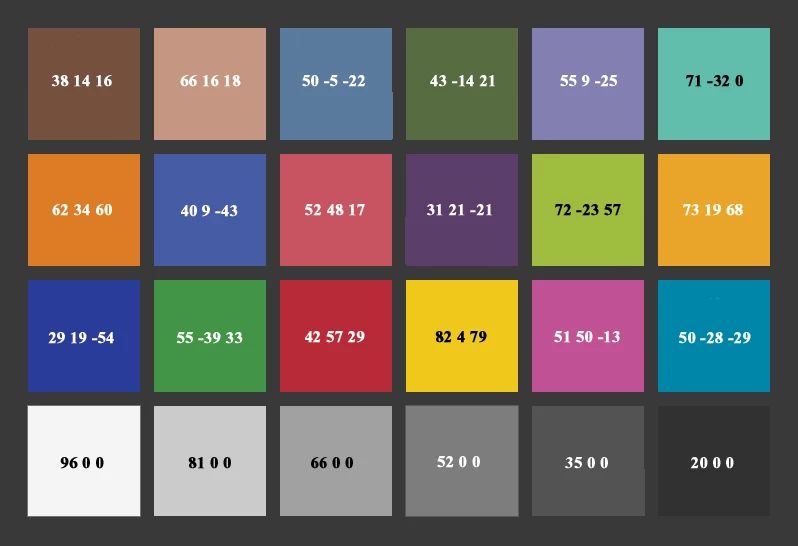

D Fosse
November 9, 2018
These are the Lab values in a standard color checker - they can be translated to any other standard color space. The file has sRGB embedded.
