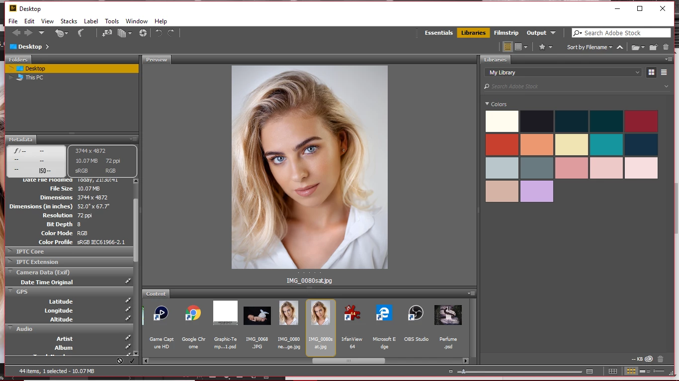

    (Below) PS and adobe bridge same

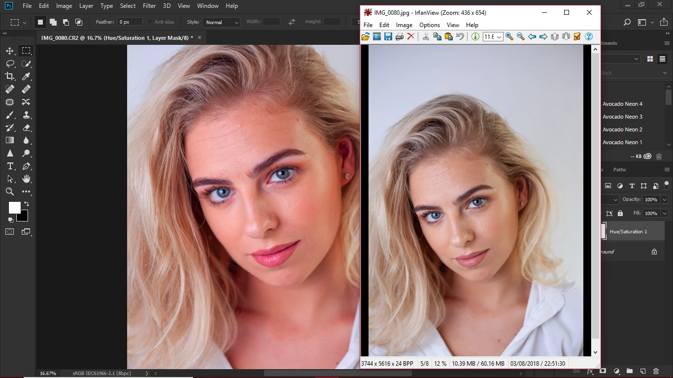

    Below is PS and Ifranview

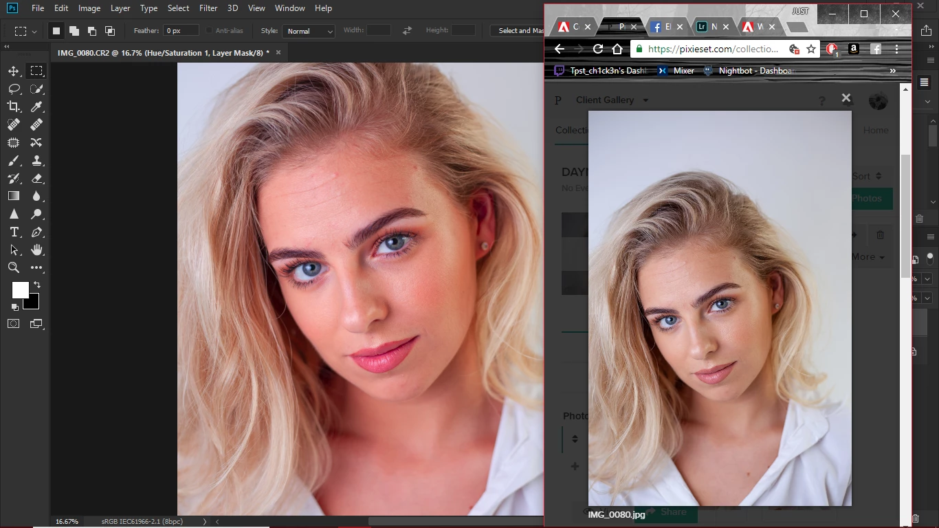

    Below is PS and Pixieset website using google chrome

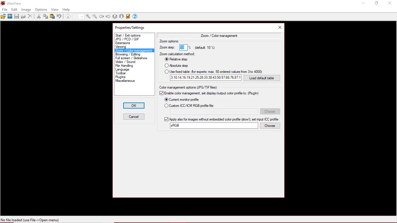

    Also i have downloaded Irfanview, is this the setting you meant Per Berntsen

    embededd document profile as in sRGB? i looked at the image in bridge and states sRGB. (see below)

    D Fosse​ Still issues my friend. screenshot of in photoshop. you can see the display profile, all other settings are default.
    On the left is an uploaded image to pixieset website which is how i usually deliver my images, clearly a massive difference, im now beginning to think either my screen is on its way out or the spyder is a dodgy one.

    as you can see here, original (no edit) then i exported 2. you can see that they are completely different

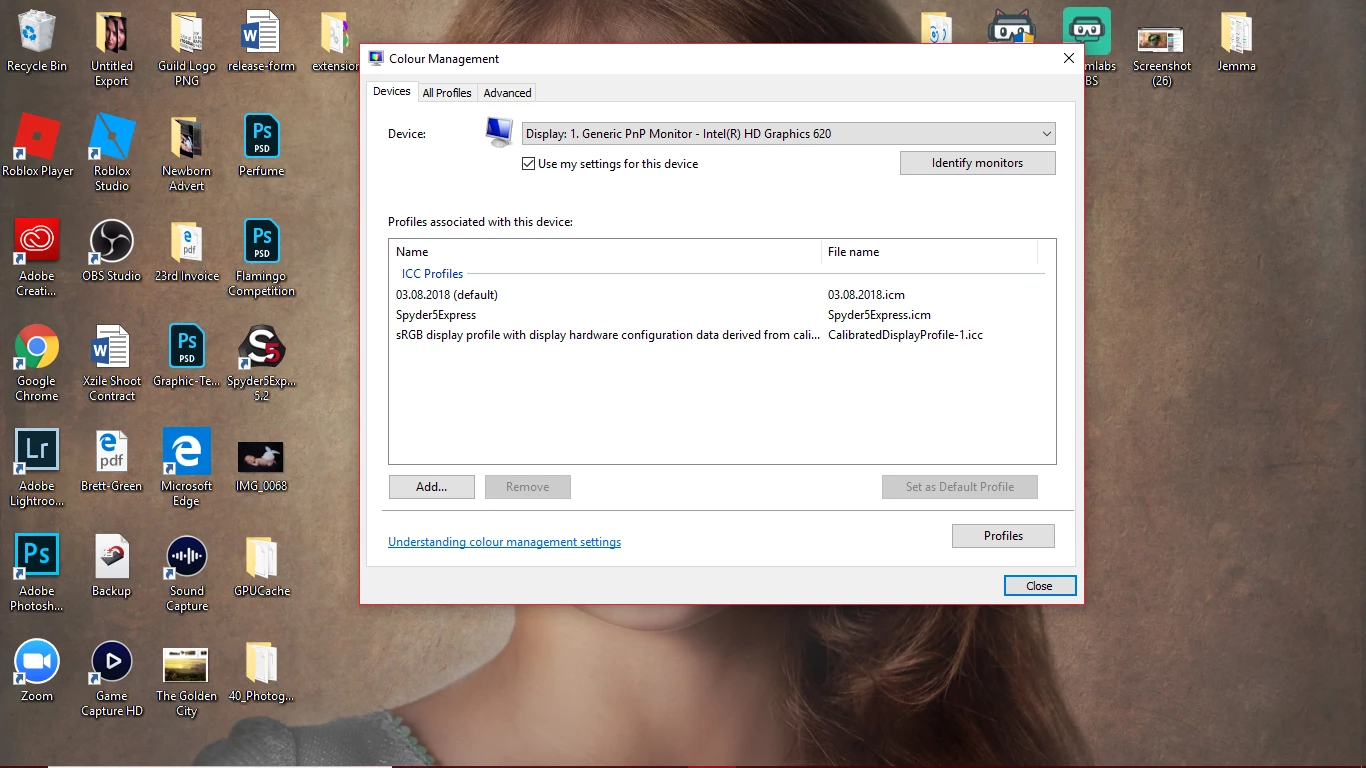

    • the monitor profile should be the one made by your Spyder. You check this at system level, in the Windows Color Management dialog. The Spyder software screenshot is irrelevant.

    The screenshot is of my monitor profile 03.08.2018 is the spyder profile created today as a fresh start.

    I thought you were using a Spyder? What happened there? Your monitor profile shouldn't be sRGB, it should be the Spyder profile. The document should be sRGB.
