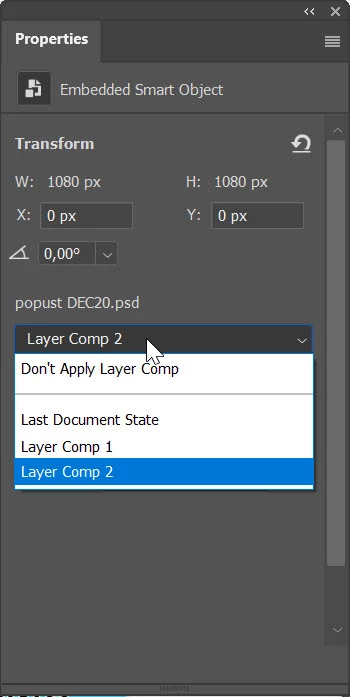

I'm not entirely clear on your request, but did you know that you can change the layer comp for a placed PSD file from the Properties panel? Of course, the placed PSD must have defined layer comps.
