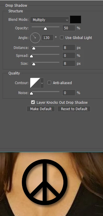

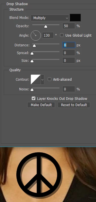

    Lara, this is how it works
    The Angle indicates the direction the light is coming from.  The shadow will always appear opposite that angle.  I tend to default to 135°, which is 45° past vertical, but you need to match the rest of the image.
    I have set the shadow to 50% so you can see it.  You can also see it is fully hard.

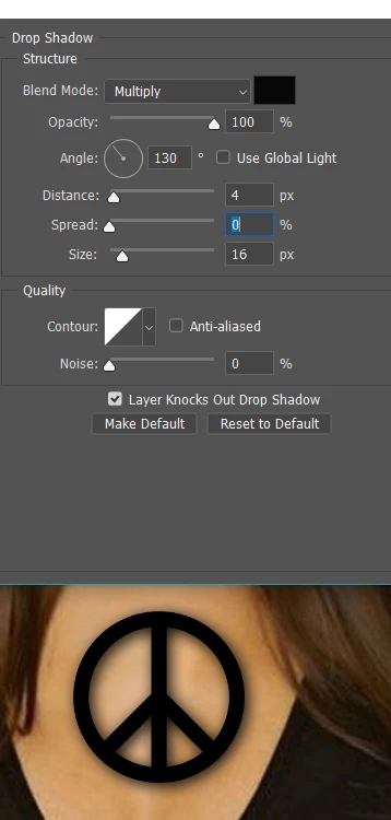

    The Size value sets how hard or soft the shadow is.
    I
    If you go too high with the size, the shadow can bleed out in all directions.  That may be what you want, so it's a tool for you to use for best effect.
    Spread works with size to set the softness and how far the shadow reaches.
    If size is set to zero, then spread does nothing.
    If Spread is set to 100%, then the shadow is fully hard, and spread will extend the shadow (a long way if yo like)
    I rarely use the spread slider.

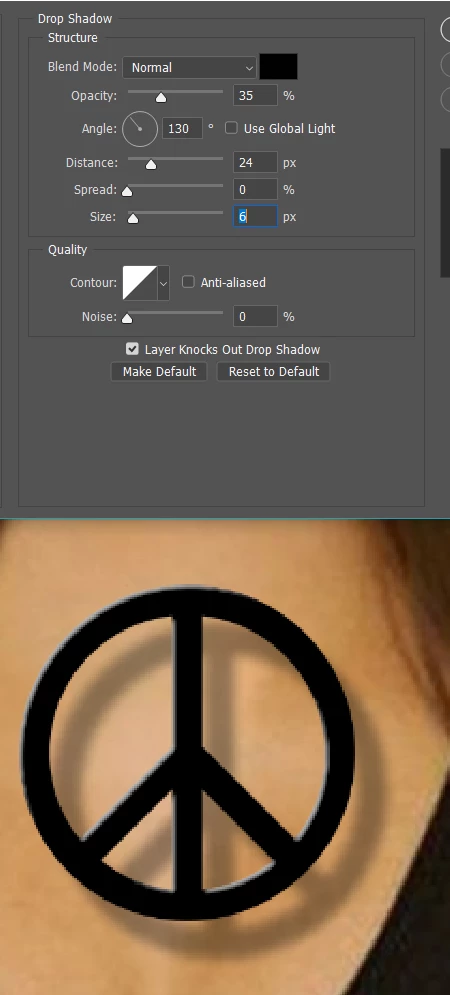

    You can use Drop Shadow for other effects as well as for shadows.

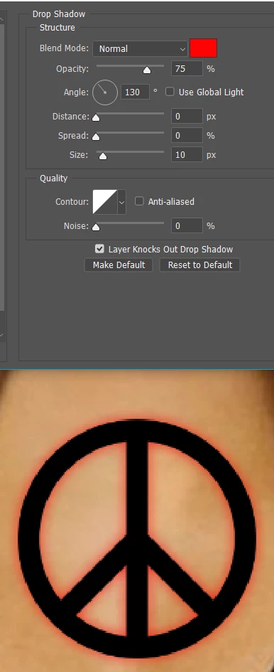

    I have changed the colour to red below, and with distance set to zero px, it has created an out glow.  I often use this for outer glow as you get more control — especially if you are looking for a soft glow.  Be aware of the blend mode though.  If nothing is happening, try setting it back to Normal.

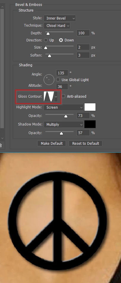

    I also gave the Peace Logo a tiny bevel, which needs some some thought with a black object
    Being a very small bevel, the standard 'gloss contour' does not show, so I have used one of the two radical W shaped curves.
    Here again, you do not _have_ to use white for highlights and black for shadows, but once again, be mindful of the blend modes if you do change the colours.
    In this case the bevel & emboss gives the badge some depth, and drop shadow lifts it from the background
    A large offset lifts the object away from its background. It's interesting when you think this is a flat screen with different tones and colours, but that's how our eyes and minds work.
