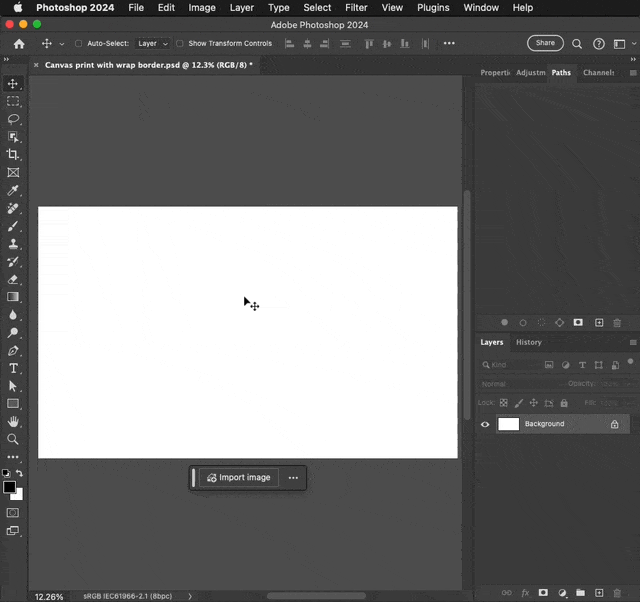

    Does the demo below cover what you want to set up?
    (Sorry about the low quality, the forum software seems to degrade animated GIF.)
    The steps shown are:
    1. Place the file as an embedded Smart Object. I did it using drag and drop, because that creates an embedded Smart Object. (Adding the Option key, or Alt key in Windows, places a linked Smart Object.) But you can also choose File > Place Embedded.
    2. Duplicate the layer. I did it by dragging with the Option/Alt key held down.
    3. Flip the duplicate. I chose Edit > Transform > Flip Horizontal.
    4. The duplicate is supposed to be the mirror wrap border, so limit the width. I did it using a vector mask, for easy editing later in step 6.
    5. Skew both layers to set them at an angle, to show the wrap around the corner. I did it by choosing Edit > Free Transform, and holding down the Command key (Control in Windows) while dragging a side handle on the transform bounding box.
    6. For the edge layer, adjust its mask for the width I actually want the edge to be after skewing. This requires first unlinking the mask, because in this step we don’t want to edit the Smart Object, just its mask.
    7. Reposition both layers. This requires first relinking the mask, and selecting both layers.
    8. Swap out another image. I did this by selecting one of the Smart Objects and choosing Layer > Smart Objects > Replace Contents. This one-step swap is what makes it a proper template.
