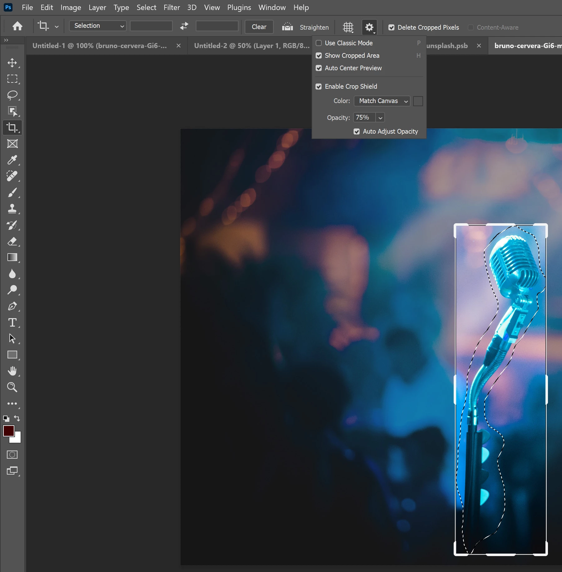

Correct answer Barrow-White
I had this issue. When you have selected the area with the crop tool, go to the top bar. There you will see a cog button 'set additional crop options', click this to show the menu and make sure that Classic mode is turned off. For me that fixed the issue and content aware suddenly came back as selectable again.

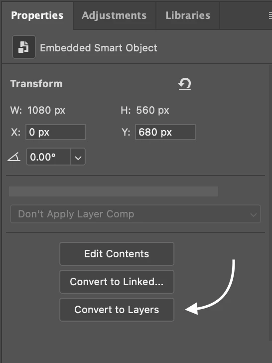

I found the solution. Make sure you convert your image into a layer. The button wasn't greyed out anymore.
January 19, 2024
You've placed your image (as a smart image), now go over to layers, right click and Rasterize Layer.

Barrow-White
Barrow-WhiteCorrect answer
April 4, 2022
April 6, 2022
OMG that took me 1,5h Thx!

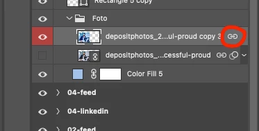

March 15, 2021
Check if this layer is linked with another layer that does not allow content-aware scale
March 6, 2021
You have to rasterize the layer that you want to use content-aware fill on. Just right click the layer and there is an option called "Rasterize Layer" Once you do that, the buttons shouldn't be greyed out.
