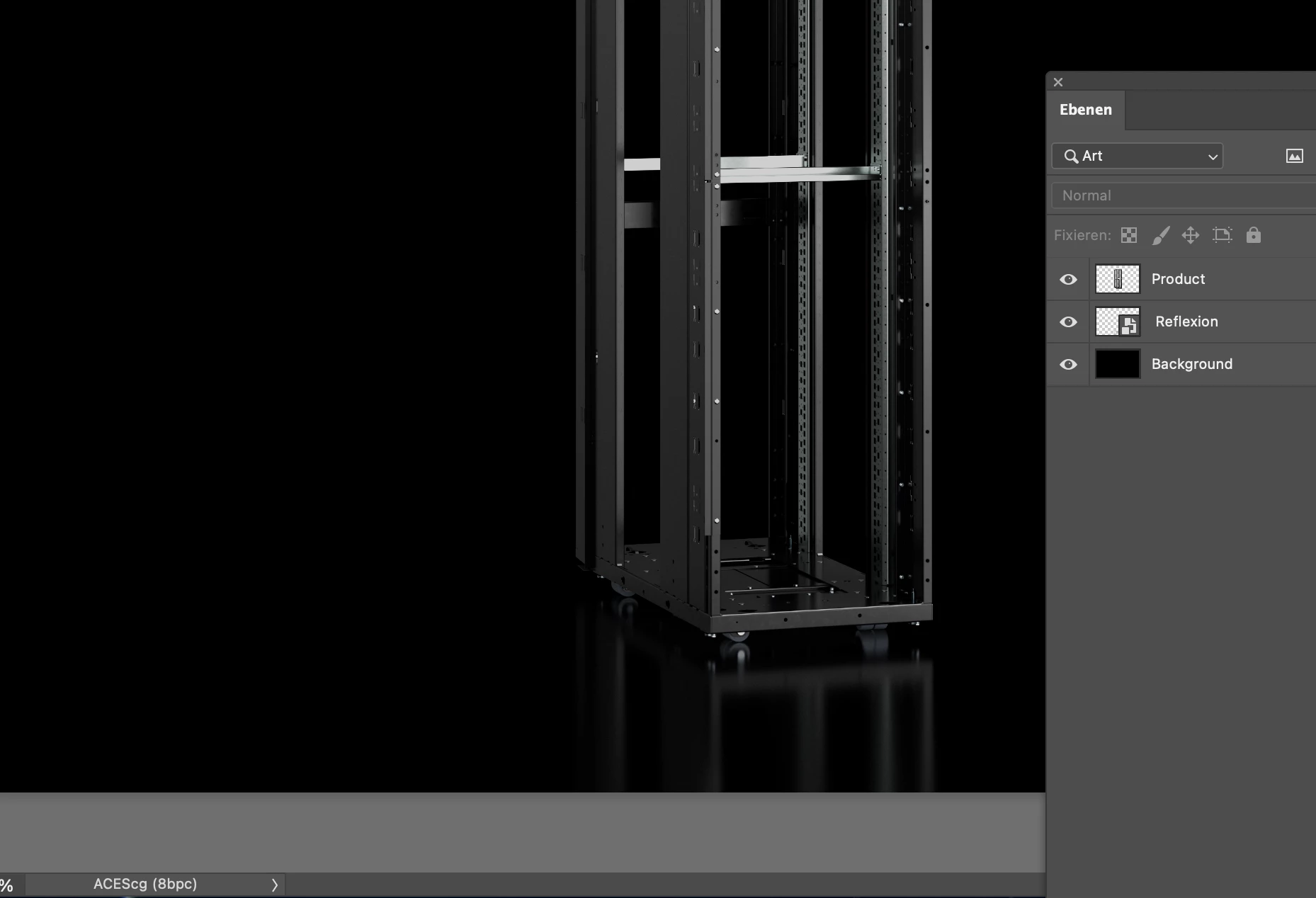

Hello everyone,
we have a question regarding an ACES workflow. Background: We render in Maya/V-Ray Multichannel EXR 32 bit files and and edit them in Photoshop.Previously, we only required 8-bit TIFF images without layers. Now, however, we need PSD or TIF files with layers and transparency.

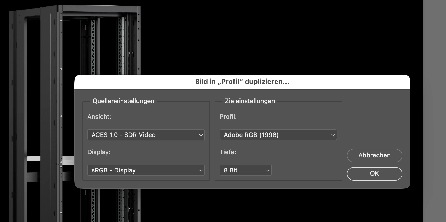

Summary: We have a PSD file with three layers, two of which contain transparency in the ACES color space (See Image 01). We require this PSD file—with the 3 layers and transparencies—in the Adobe RGB color space. If we use "Duplicate Image Into Profile" (see image 02), the image looks exactly the same as before, but we lose all layers and transparencies.
Is there a way to convert the image—including layers and transparencies—to the Adobe RGB color space?

    @Lars Gerstenmaier So when doing it this way - you’ll want to make sure to “open as OCIO”, then select one of the AdobeRGB spaces as your working space, then select the ‘wrap in smart objects’ option with ‘ACEScg’ as your input space. You can always rasterize the layers which will bake in the ACEScg→AdobeRGB conversion and make them normal pixel layers again.
    Also I just noticed you mentioned eciRGB - which is not the same as AdobeRGB. eciRGB uses a D50 whitepoint with slightly different primaries and I believe a different transfer function. There is no eciRGB space in the default ACES configs. For that, you’d need to modify the configs to define a colorspace for eciRGB.

    The reason I ask is that converting a layered file with transparency between colorspaces isn't as straightforward as it might seem with multiple RGBA layers compositing together. When layers contain transparency, the way those pixels blend together depends on the colorspace the data lives in — linear ACES and gamma-encoded AdobeRGB handle that blending quite differently. So if we simply re-encode the RGB values into AdobeRGB, the edges and soft transparencies can look different even if the solid colors appear the same. That's also why “Duplicate To Profile” flattens the image — retaining layers while baking in a colorspace transform could cause the compositing to look very different.
    The proper OCIO way to work in a target colorspace like AdobeRGB is to set it as your working space in the OCIO panel. When you do this, all smart object layers dynamically convert to that working space, and everything looks the same — with the caveat that transparency blending won't be fully correct, since gamma-encoded AdobeRGB handles alpha blending differently than linear. For more correct transparency blending, you'd want a linear AdobeRGB colorspace defined in your config instead. Either way, the key requirement is that your OCIO config actually defines the AdobeRGB colorspace you want to target — it won't appear as an option otherwise.
    It's also worth noting that the profile you select in Duplicate To Profile currently isn't actually transforming the pixels into that colorspace — it's just attaching that profile as metadata to the output. It's on you to make sure the profile you choose matches the display you have selected, otherwise the result won't look as expected. This is something we're actively working on improving.

    ​@Lars Gerstenmaier - I'm not familiar with your image 2 screenshot, can you post a screenshot of the menu command highlighting where this feature is located, as I think it's getting lost in translation.
