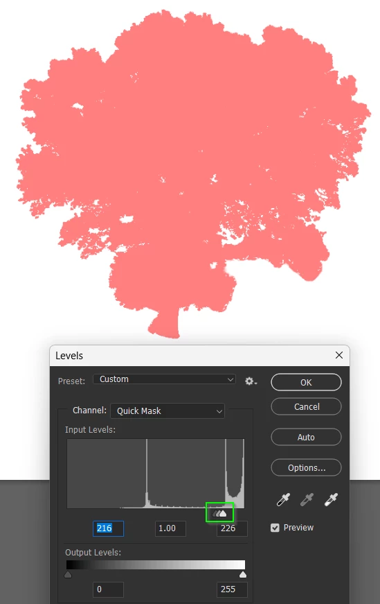

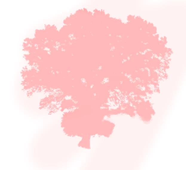

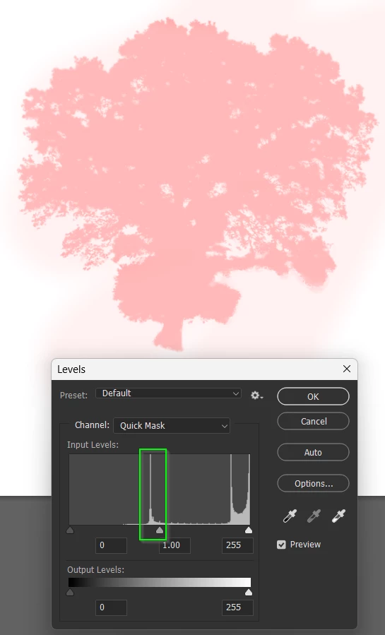

This is about 60%.  I am showing against white to make it easier to see.
I have initiated a Levels adjustment.  The green highlight shows the pink pixels.
I'be bunched the pink pixel value as close as I can get it to the whites.  (I had some 10% pixels  — top right of image — selected shown by the ramp on the right.) When I turn off Quick Mask I'll have a very close to 100% selection.  When selections are a bit thin, just copy the layer a bunch of times (set to Normal) to firm them up.
