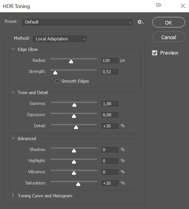

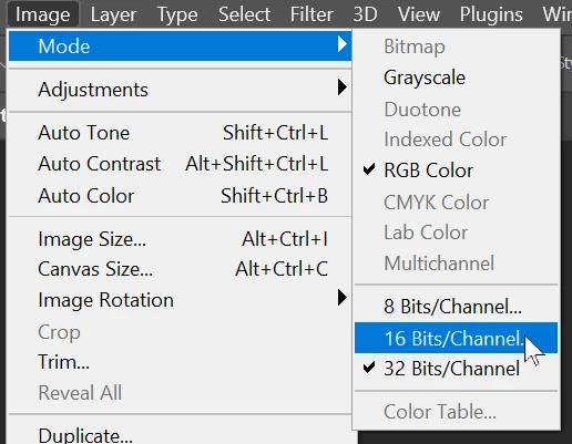

I want to convert a 32-bit image to 16-bit before working on it.
Normally I go to IMAGE -> MODE -> 16 Bits/Channel
In stead I get the HDR Toning dialog, not the mode change dialog
Already tried resetting all preferences, restarting Photoshop 2021, and even rebooted the PC. to no avail.
I cannot change modes anymore.
Running Photoshop 2021 (22.0.0) on Windows 10

PMeestersAuthor
October 28, 2020
Thanks guys,
I guess I was mistaken, and thought that option was gone. Looked in the wrong drop-down box 😞 dunno why I did that 😞
My mistake 😞

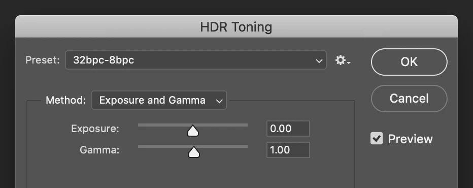

Stephen Marsh
October 28, 2020
32 bit files require tone mapping. If you don't really have HDR data and don't wish to have the image visually altered, use the option for gamma 1. Sorry I'm not in front of Photoshop and can't recall the actual name etc.
EDIT: Now that I have access to Photoshop, here is the setting that I was referring to –
