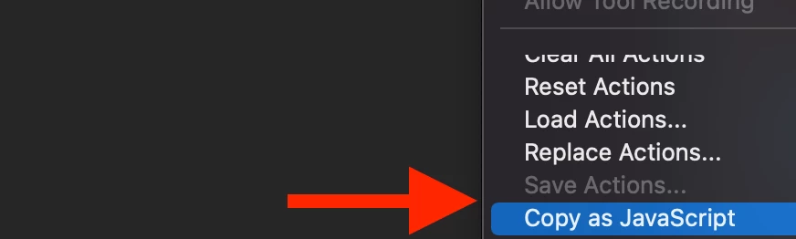

I would like a script that invokes this command

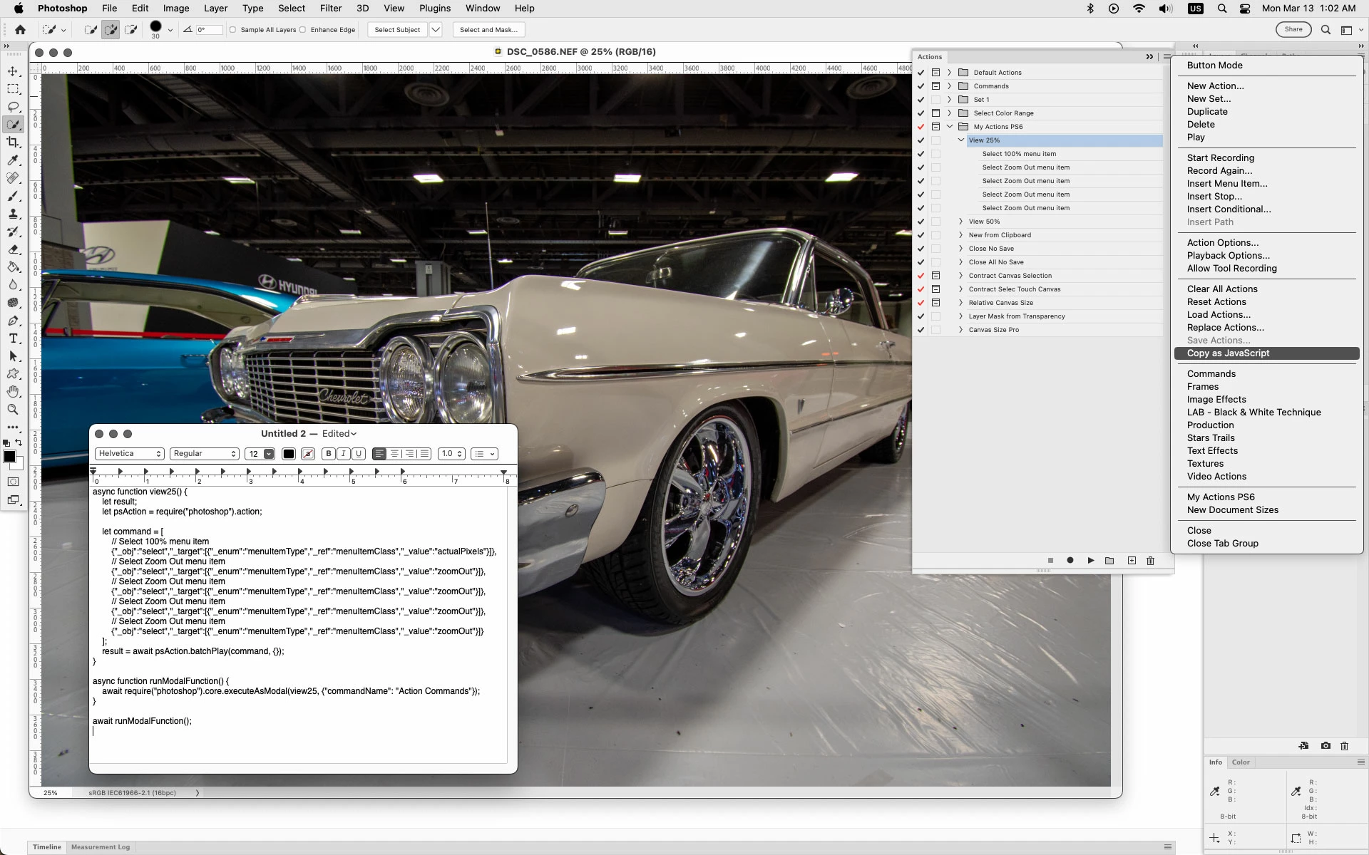

In the Photoshop >Preferences (Settings)>Plugins (mac) or Edit>Preferences>Plugins (windows) check Enable developer mode, then restart photoshop.
Stephen Marsh
March 13, 2023
Ah, thanks @Jeff Arola – I don’t do any UXP development, so I don't have that active!
As the command is greyed out for "Insert Menu Command" and isn't recorded into an action, I don't know of a way to access this menu item via scripting.
March 13, 2023
I started doing some uxp programming and with this entry I convert actions to file. js, the problem is that whenever i have to convert the action i have to do multiple steps to select the item in the action menu, I need a script that calls quickly copy to JavaScript

My Actions panel doesn't have such a menu item.
The x-tools script package from xbytor does include scripts for converting actions to JavaScript.
March 13, 2023
What are you asking for? Please explain what this script would do (input->process->output)
