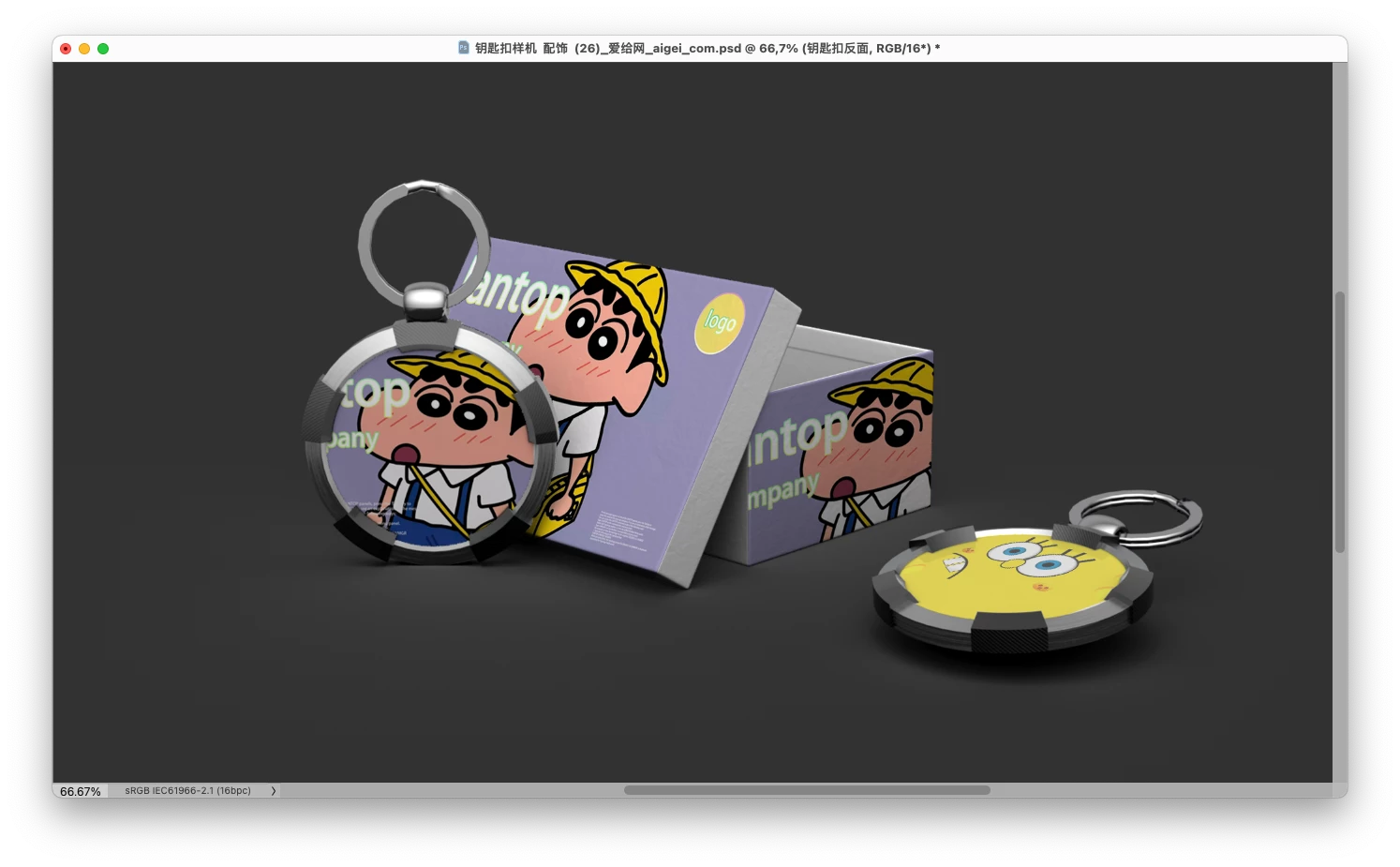

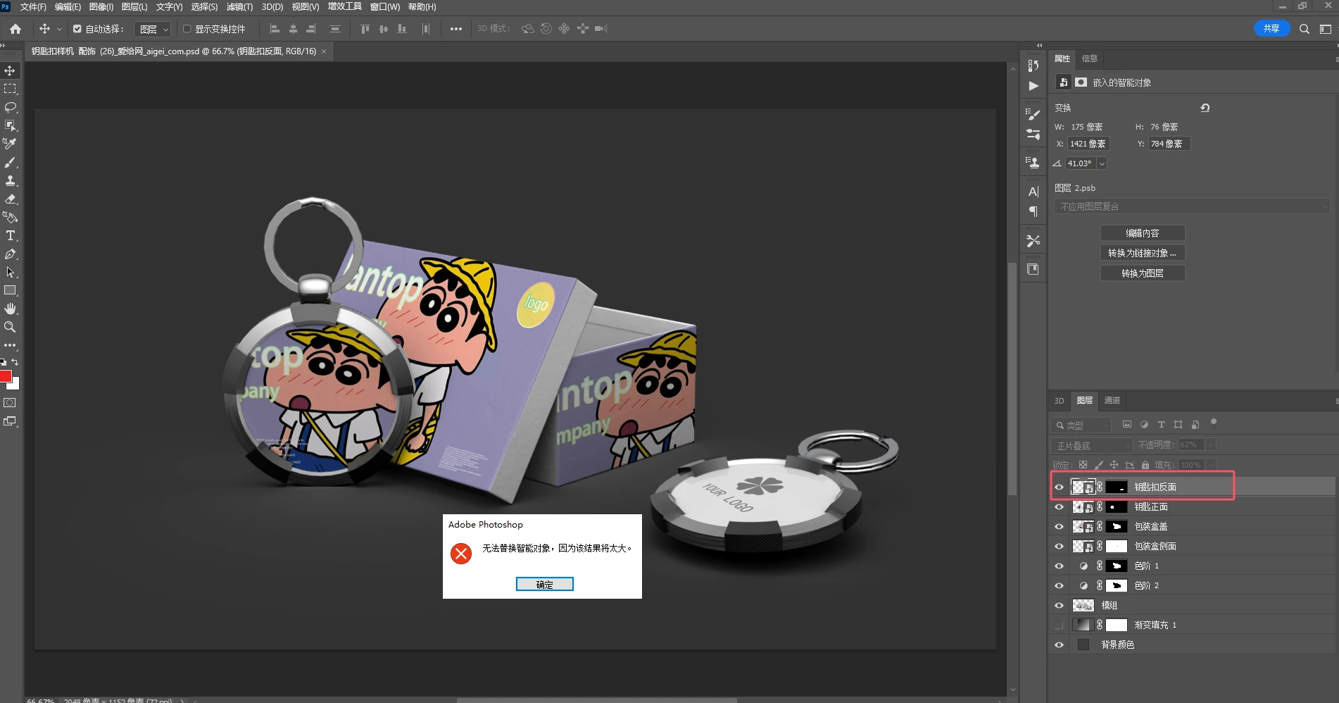

Could not replace smart object because the result would be too large
The smart object layer successfully replaces the content with succ.png, but an error occurs when using error.png, as shown in the image.
Are there any size limitations for the replacement image? I am using a script to perform the replacement, and I would like to have precise rules to define these limitations.

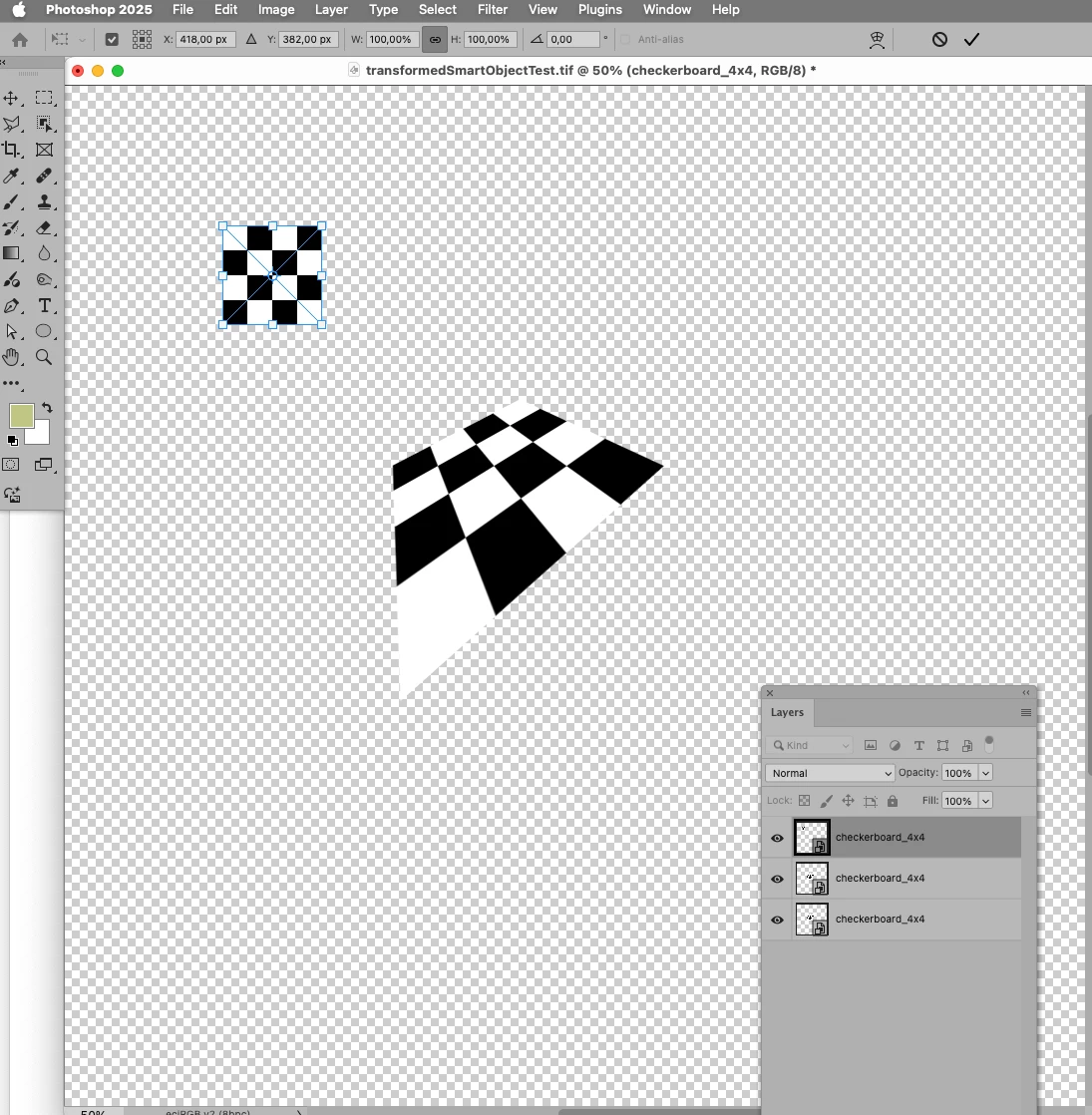

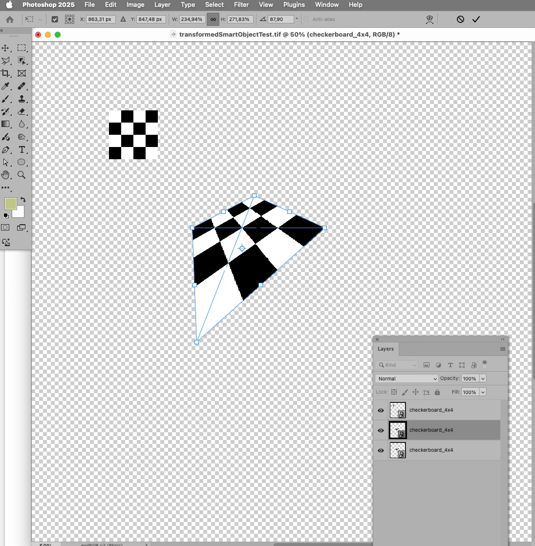

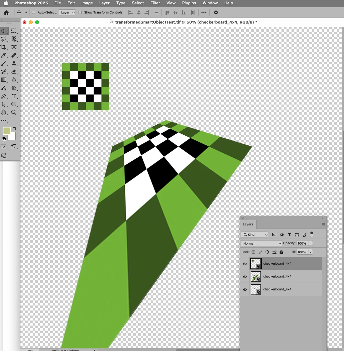

To illustrate what happens when one changes a transformed Smart Object’s content’s dimensions.
The added pixels can be larger than the original increase might lead one to expect.

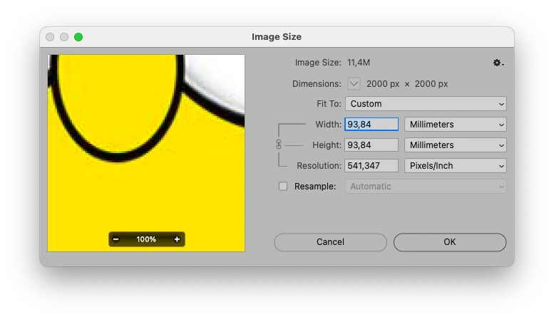

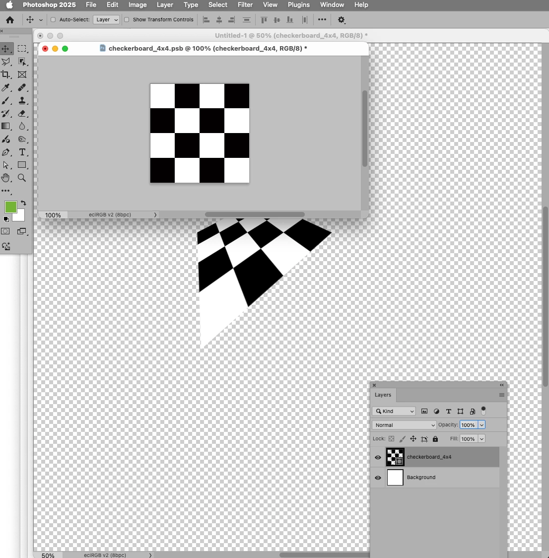

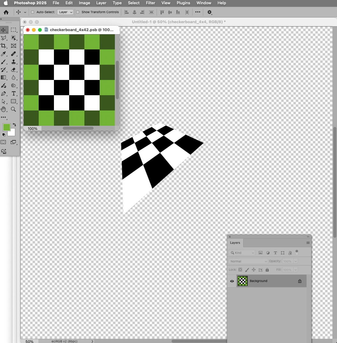

I can reproduce.
Solution:
• The perspectival transformation causes issues because of all that additional space, so change the replacement image to the exact same side-lengths as the original Smart Object (without »Resample«).
