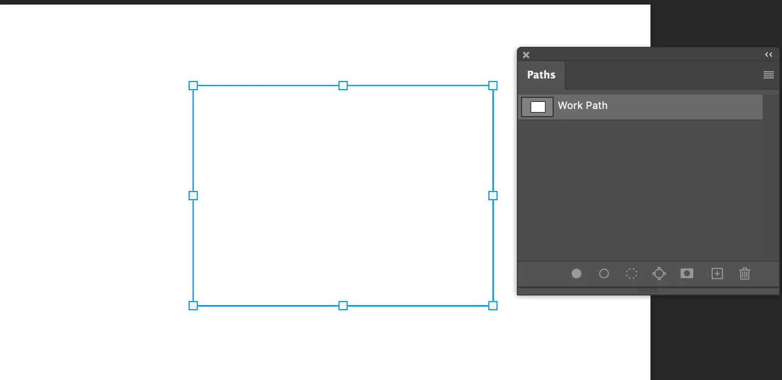

Just read it again with Path it is a bnit different.
You need to have the path active
checkout the 2 screenshot.
If it is a path you can activate it and it does not matter if you are on a certain layer.

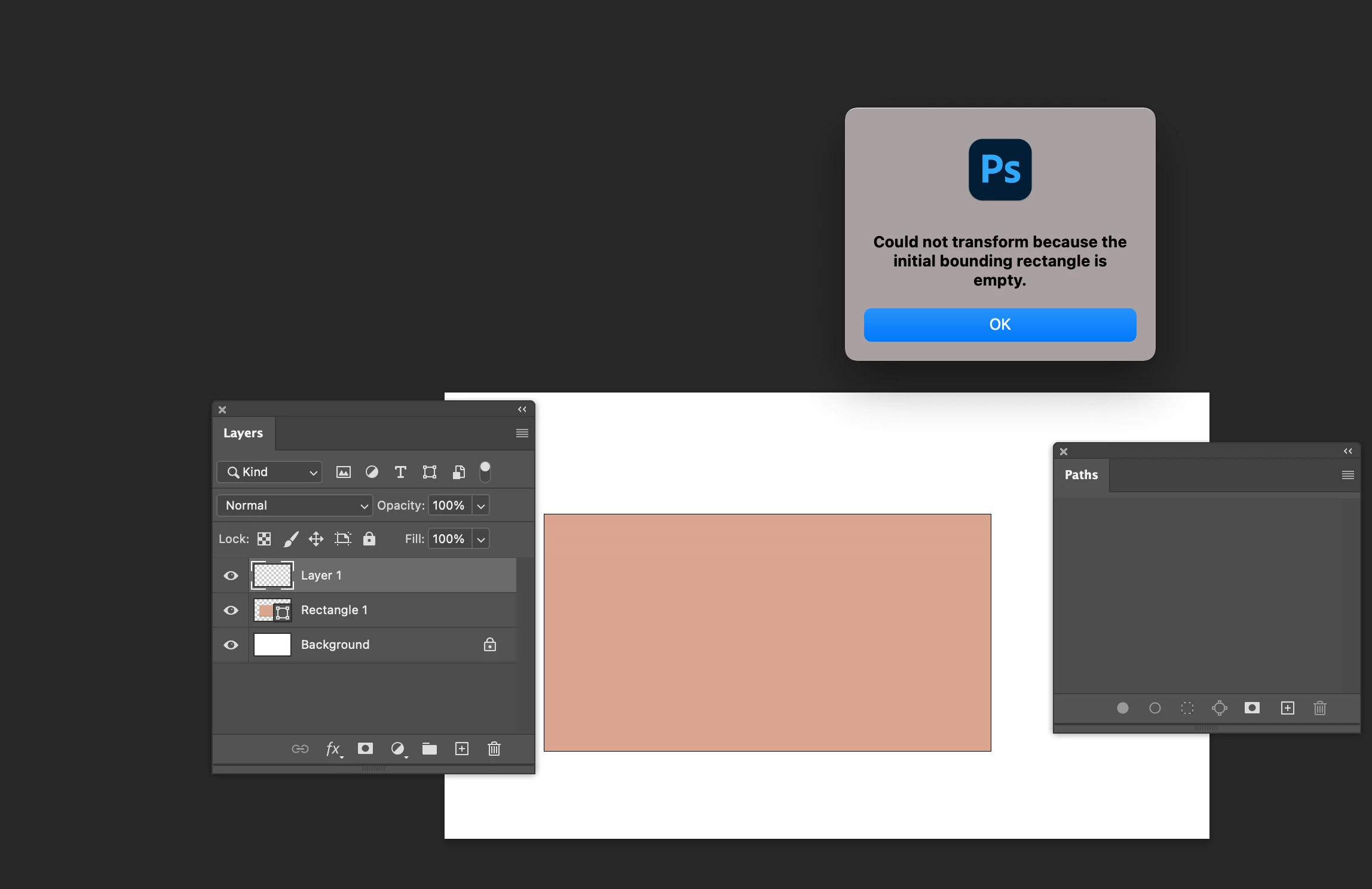

If you create a shape layer and need to transform you need to be on the layer the shape is.
Look at the screenshot Below I am on the wrong layer. Got the error message.
Hope it helps.
Hope it helps.
