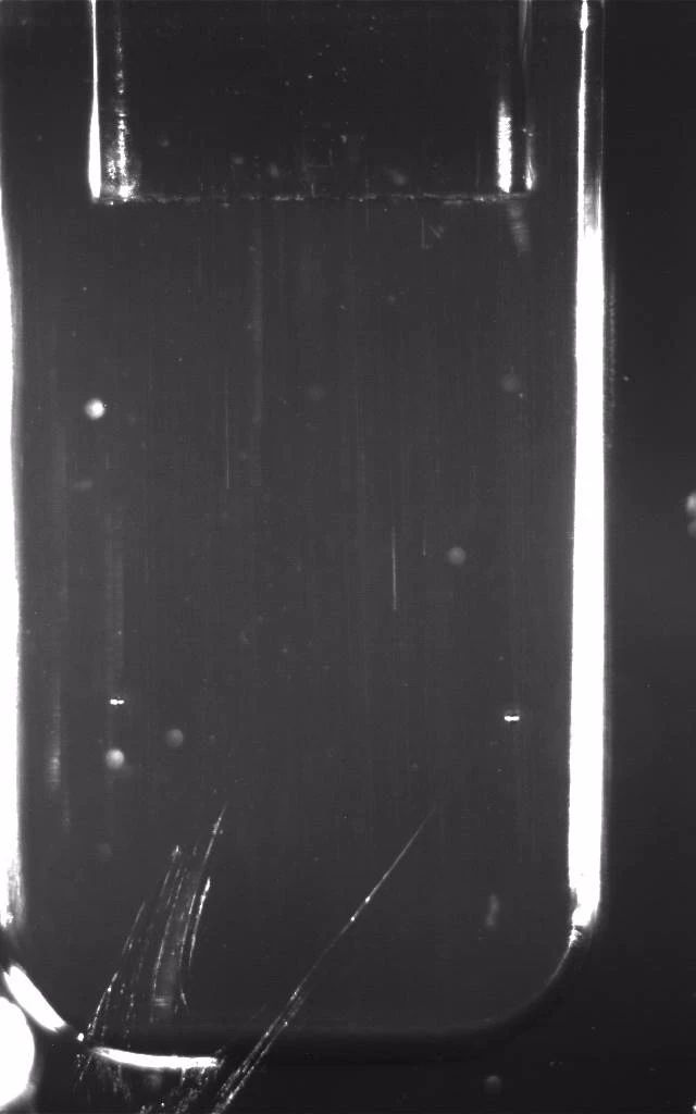

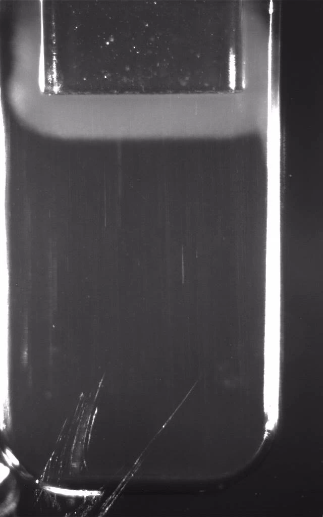

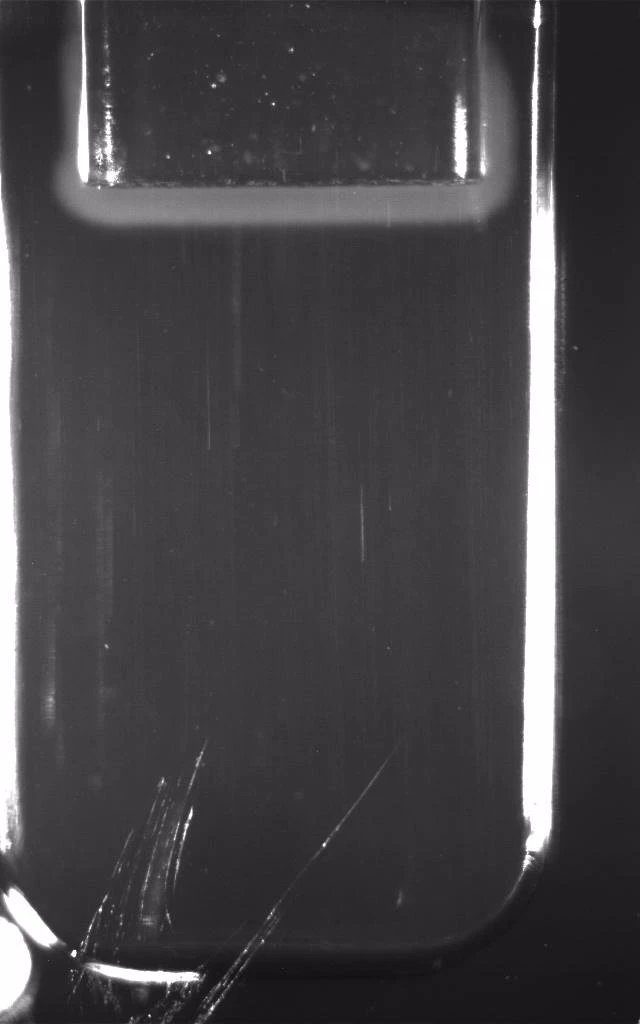

I was asked to help solve the following problem for a small scientific study in the field of ophthalmology - there is a video sequence from a tomograph display describing a fairly long process (about 30 thousand frames), it is necessary to:
a) Plot a graph of the increase in the number of white pixels (that is, APPROXIMATELY calculate how many new pixels appeared in each new frame compared to the first, regardless of their brightness)
b) Plot a graph of the optical density assessment (that is, APPROXIMATELY calculate how much the brightness changed on average in each frame relative to the first) I am only interested in the upper part of the image.
I had a plan to use histogram and difference mode to exclude the background image and evaluate both parameters and... it failed 🙂 - it turns out that the object in the upper frame is slightly shifted in time and it is difficult to isolate new colors on such a large number of frames (and yes, automatic alignment does not work well here, I checked) Three examples from this sequence are attached to the message (the initial state of the process, the middle and the end).
I do not need a working code, but only a fresh idea on how to separate the background image from the newly appearing colors using Photoshop, I will be glad to any suggestions 🙂

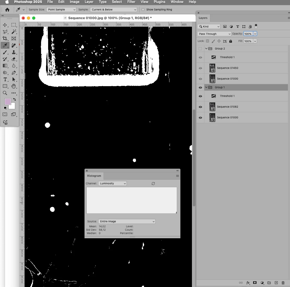

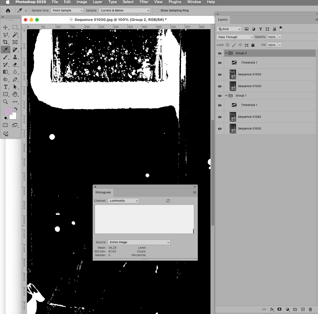

Maybe Threshold could be employed to »suppress« some of the noise/offset.

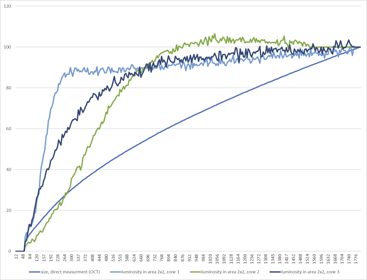

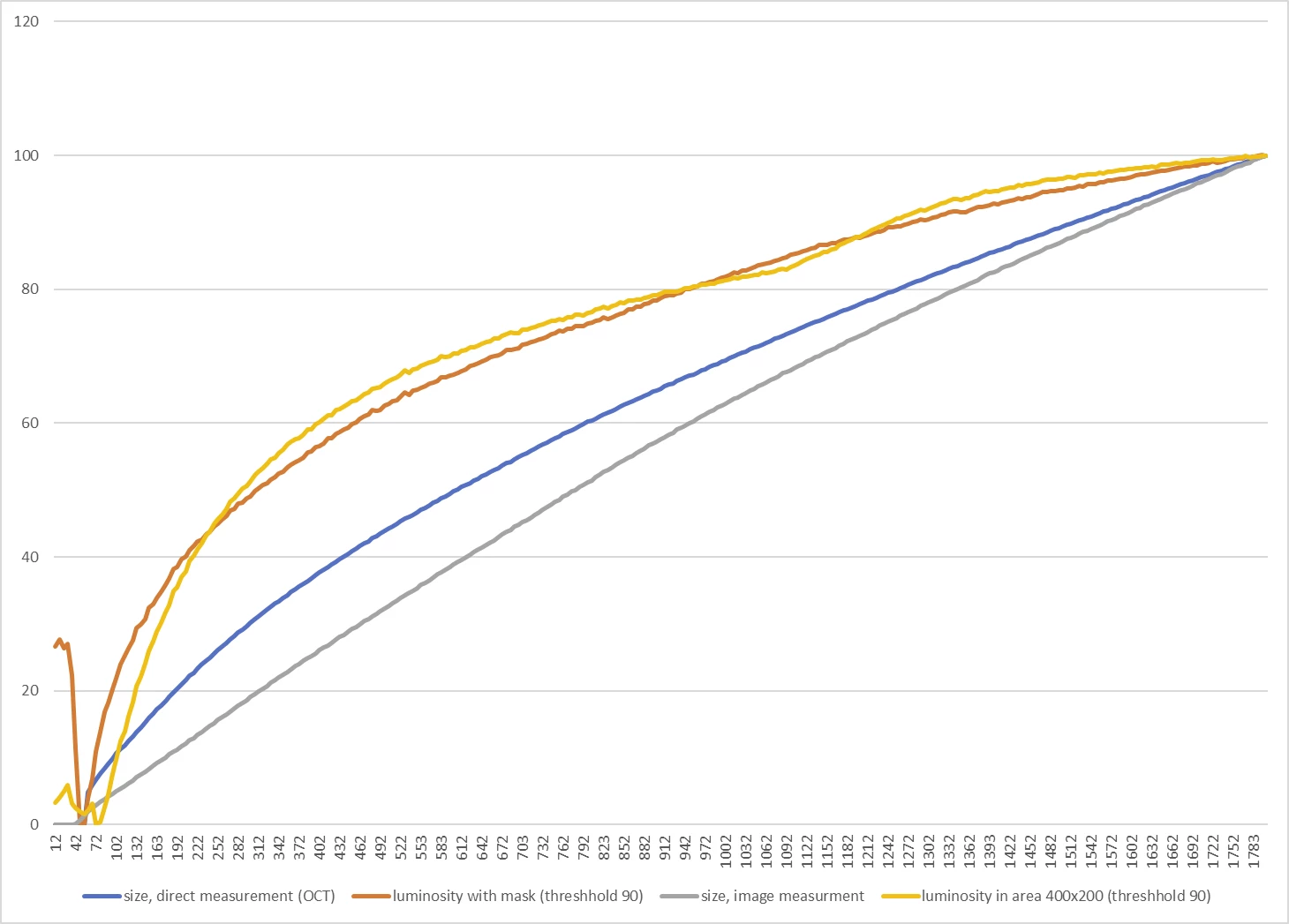

Thank you all! I decided to use both methods - limited all insignificant areas with a mask and set the threshold at around 90 brightness units to eliminate background noise.
if I make measurements point by point (2x2 pixel square), then the data is also quite close (although, apparently, noisy, also the intensity of the brightness change obviously depends on the point at which it occurs)

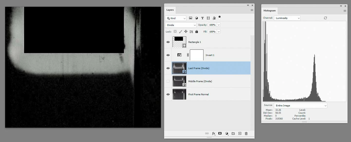

Jul 1, 2025 10:00 PM UTC
Interesting problem. I wonder if you could use divide blend mode along with an Invert and then a black rectangle to mask the top section. Like you said, with slight movement it won't be exact but might give you enough for an approximate result to plot as a graph, particularly if you cropped to the top section.
Dave
