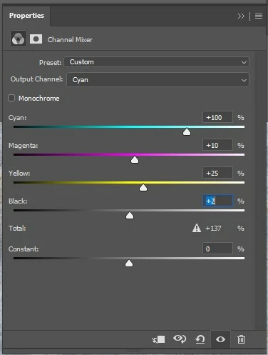

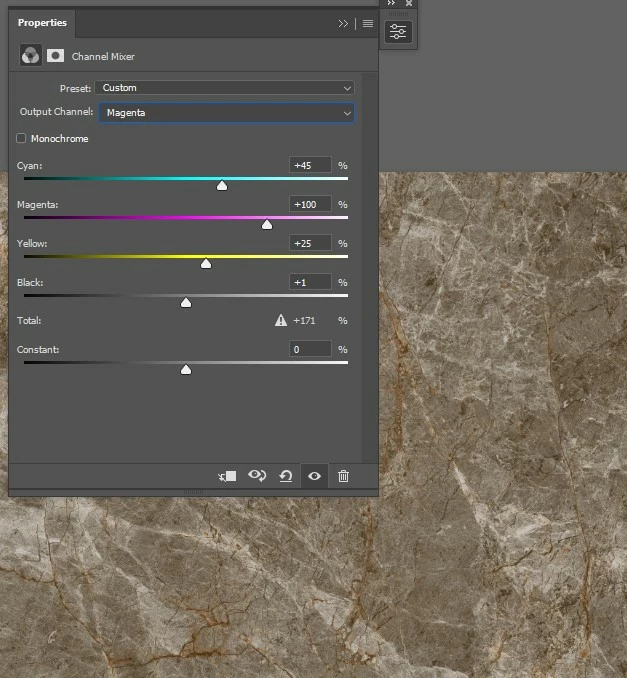

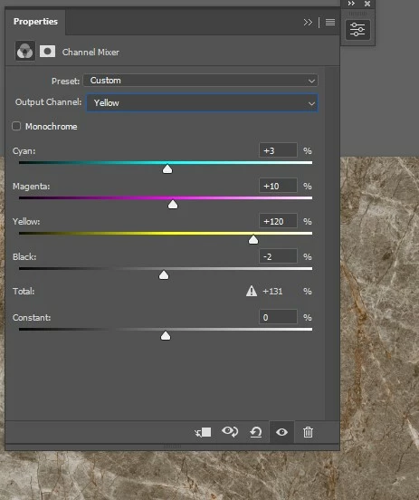

this is my code, but in this code only change same channel with same color, but i want change in
cyan channel, color value cyan=100, magenta=10, yellow=25, black=2
magenta channel, color value cyan=45, magenta=100, yellow=2, black=1
yellow channel, color value cyan=3, magenta=10, yellow=85, black=-2
black channel, color value cyan=-5, magenta=6, yellow=0, black=100
if any have solution please help me to solve my problem and if you have better solution please help me.
