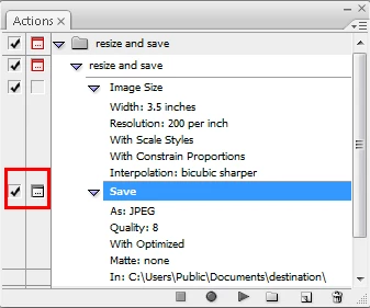

I have several folders of  TIFF images.  I need to process them individually, then save them as JPG in the same folder the original TIF was in.
I  created an action with provides several of the final steps I need, including the "Save As".  I clicked the "modal" option for the "save as" step, so I can edit the name as need be before saving.
My problem is the action "remembers" the directory path in which the action was created (i.e. the first folder).  When I run the action on images I've opened from other folders, it defaults to the first folder.  So I need to navigate to the current folder every time.  This is a pain.
How can I just have the action open the save as dialog to the same directory as the currently open image?

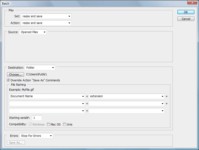

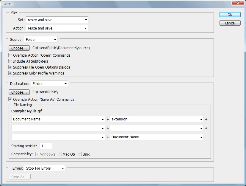

    You could use File.Automate>Batch
    Set the source folder to the folder with your images.
    Set the destination folder to any folder (does not matter in this case)
    Check the Override Action "Save As" Commands box.
    Under Play, choose your action with the save step.
    With the enable dialog checked in the save step in your action,
    using batch should open the Save As dialog in the source folder.
    If you would rather open all your images first, instead of one at a time,  you can set
    the source to opened files.
    If you do it this way, it's probably a good idea only have the images that you want to
    process open. (i.e. images from the same folder)
