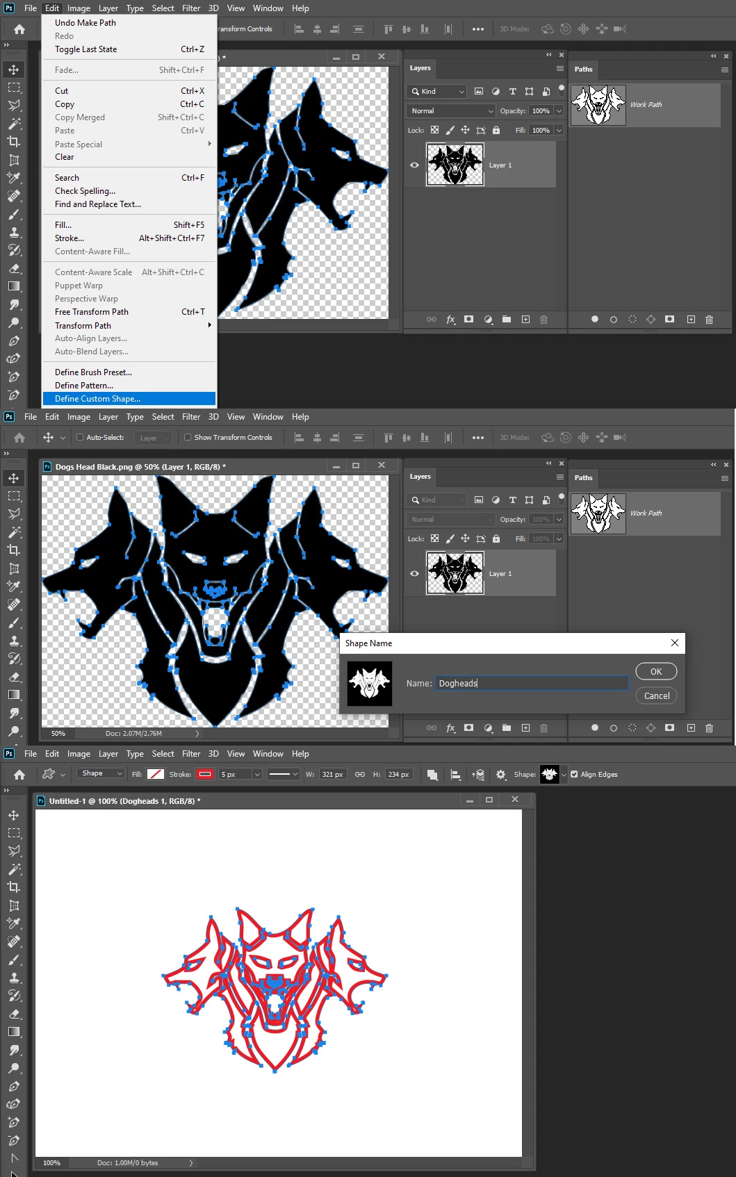

JJMack
Jan 17, 2020 6:06 PM UTC
Ctrl+Click on Png Layer Content Thumbmail
Convert the Selection to a Path
Define a Custom shape
Use]]x the custom shape tool.
