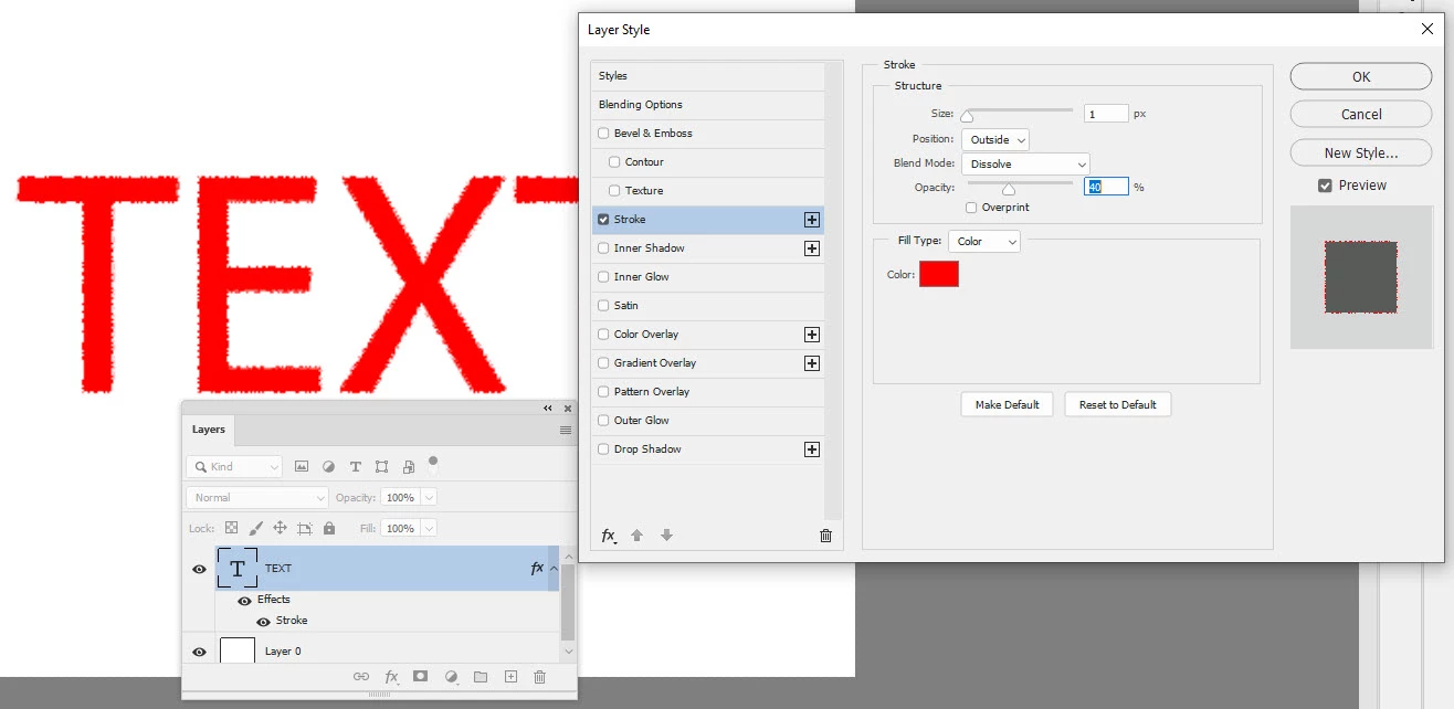

davescm
November 17, 2019
Hi
An alternative to consider which allows you to stay in Text /Vector shape is to add a layer style with a small stroke set to Dissolve Blend mode
Dave

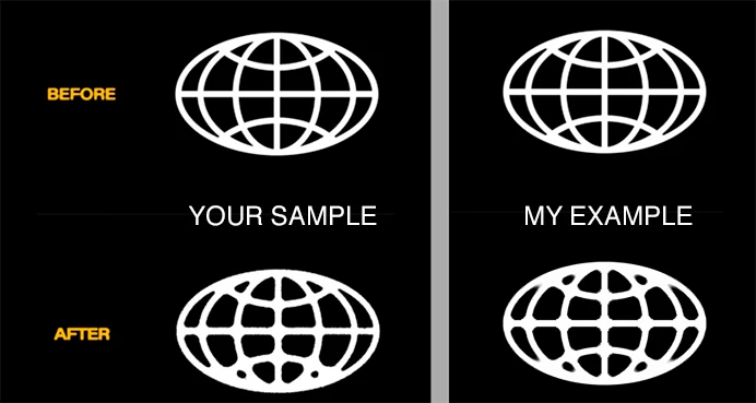

c.pfaffenbichler
September 26, 2019
ravis24269721
September 26, 2019

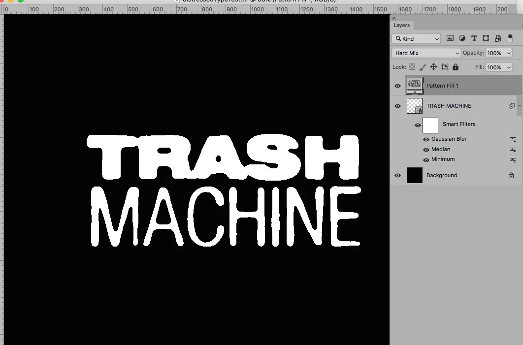

Hey! right, let me try the Displace as a smart filter and I will show you if that's alright with you, thank you so much for your continuous help!

ravis24269721
September 26, 2019

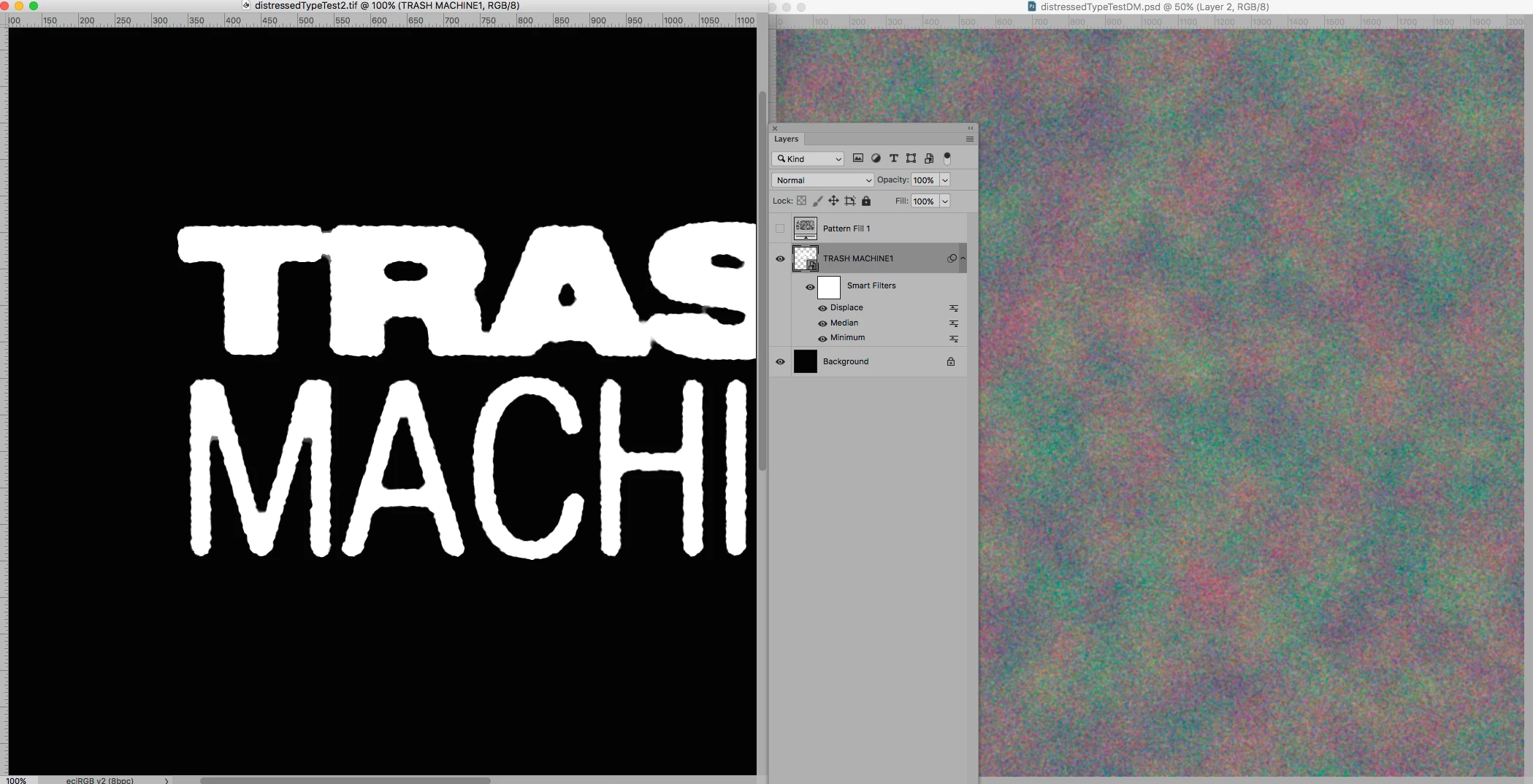

Hey Hannah, thank you ever so much for your reply! I did figure it out! but the Hard mix option on the font can only happen to white text only, the graphic element of the Picture Fill won't work on any other colour, I think I may need to copy and paste the font above and save as clipping mask. I have figured out the Median and Minimum which works wonderfully. but there must be a way to change the colour of the font without the picture fill ruining with it's visuals. Splitting the pack off of blk market would be a dream! have you tired this vintage effect and how far have you reached? Ravi

c.pfaffenbichler
September 24, 2019
ravis24269721
September 26, 2019
That's epic, thanks for this, seriously. I didn't realise that the filters "other" would show smart filters median and minimum which works perfectly but the Picture fill only works on a white text / font and won't work with any other colour as the picture fill is visible in other colours with the Hard Mix, any suggestions? I will try however to copy and past the same wording at the top and save as clipping mask ontop of the picture fill, hopefully this would work. Thank you btw you let me discover new filters I didn't think to use.
c.pfaffenbichler
September 26, 2019
Sorry, I don’t quite follow concerning the colors-issue.

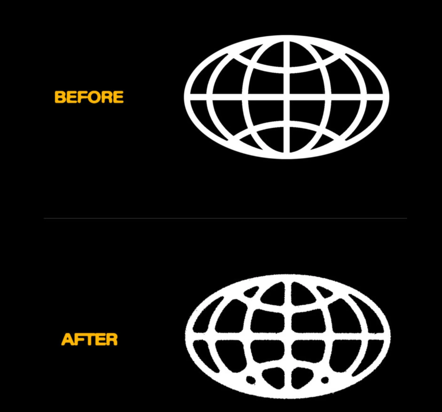

Norman Sanders
September 24, 2019
Filter > Noise > Dust & Scratches...Radius 4 pixels Threshold 0 levels
Then choose Curves and move the highlight endpoint horizontally slightly to increase contrast
ravis24269721
September 26, 2019
Hi there Norman, I did try this but the curves didn't work for me, thanks for your reply though, Let me try again with the curves... Ravi

Layer Styles, Smart Filters and Pattern Layers with Blend Modes can be used to distress originally sharp elements (like vector Smart Objects), but this is the Photoshop Forum, so if you are looking for final vector output this is not the ideal place/tool.
