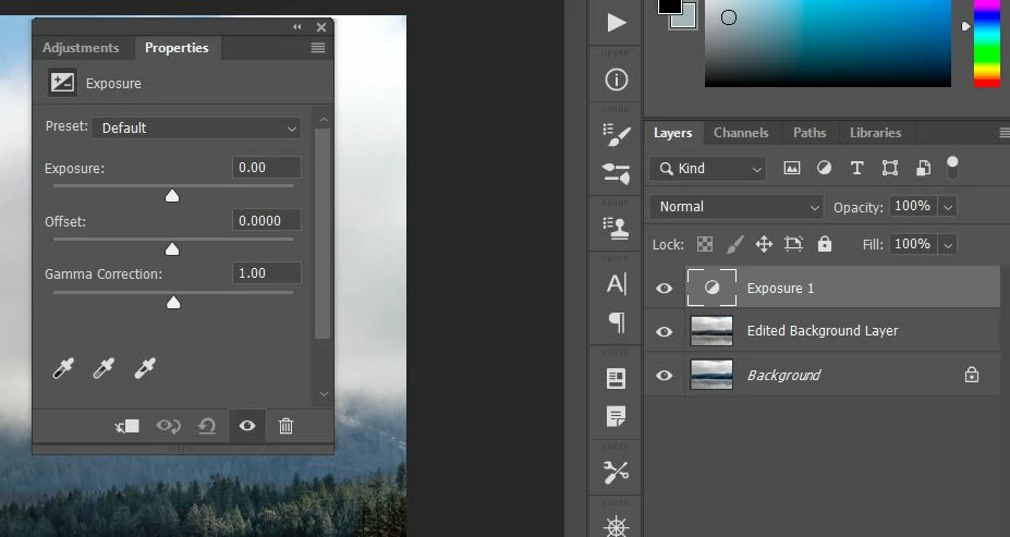

I am trying to get a grasp on adjustment layers and layer masks.  I have been watching numerous tutuorials and one thing I've noticed is they all click on the adjustment layer they want to use, example: Exposure and up pops a settings box and on the right under the layers panel there is a box with a circle in it.  Fine so far.  In ALL the tutorials I have watched a blank white layer mask appears at the same time.  The instructors then go about painting or whatever using that layer mask.  When I do it, the white layer mask does not appear.   In order to get a layer mask I have to click on the Add Layer Mask at the bottom of the panel.

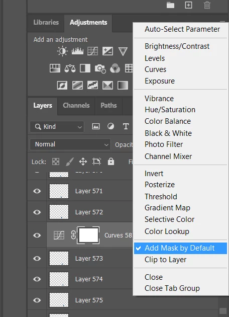

Rob_Cullen
October 4, 2019
Thanks Chuck, I am learning also!
So, select the [Adjustments] tab, and click the 'four bars' icon for the menu.
Great.

Chuck Uebele
Chuck UebeleCommunity ExpertCorrect answer
October 4, 2019
You might have creating masks for adjustment layers turned off.
D R Smith
D R SmithAuthor
October 4, 2019
That did it. I didn't have that selected. Thank you very much!
Rob_Cullen
October 4, 2019
Disclaimer- I am NOT a Ps expert!
Your adjustment layer looks strange! It shows an icon that is the icon used to 'create' an adjustment layer.
When I add an 'Exposure' adjustment layer I see this- The +/- icon:
So I presume you are at the 20.0.6 release of Ps (the "Latest").
My only suggestion is to reset the Preferences- Open Preferences and click the button on the General page-
