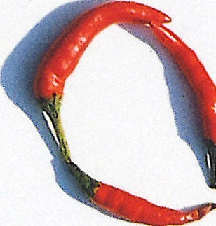

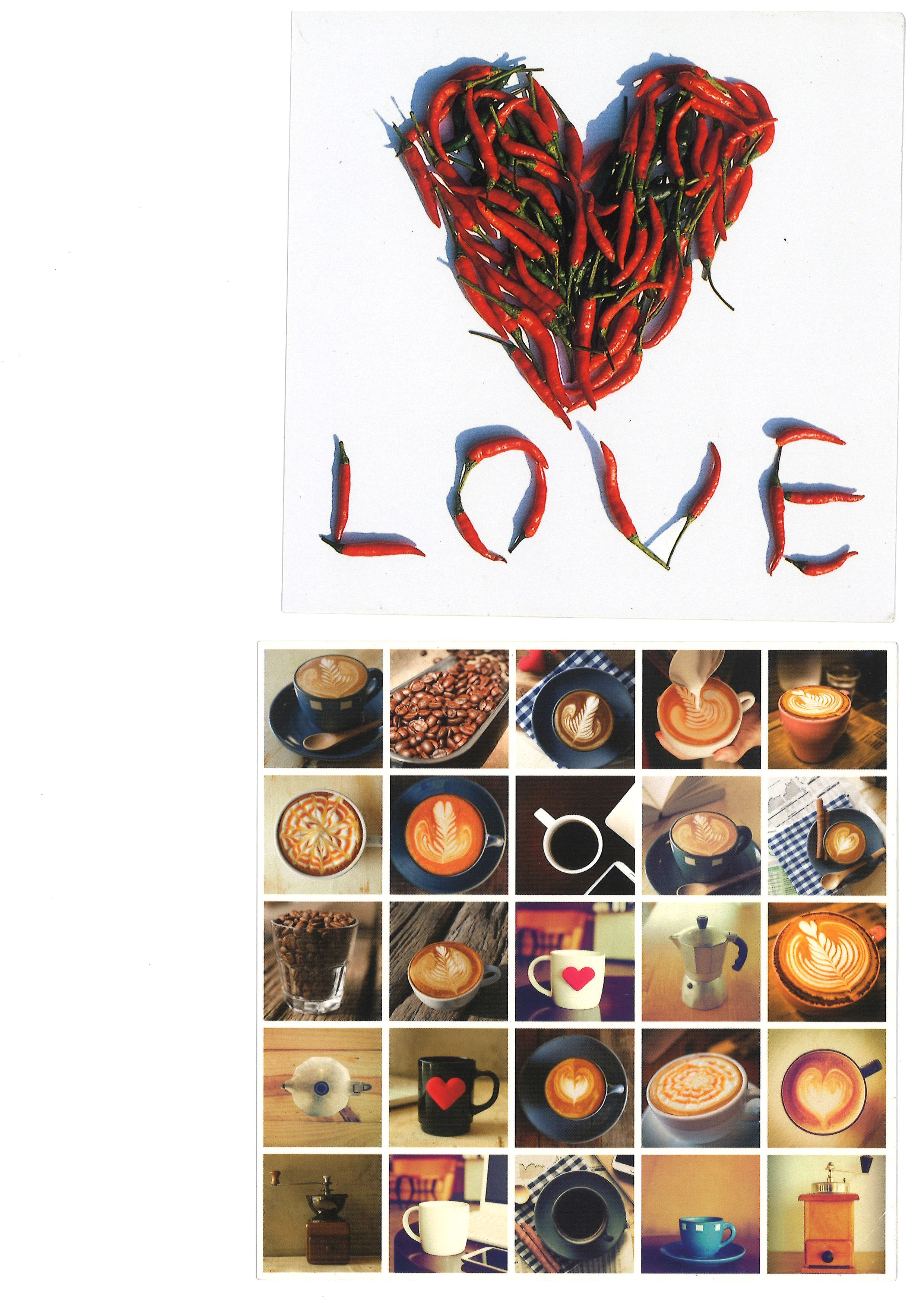

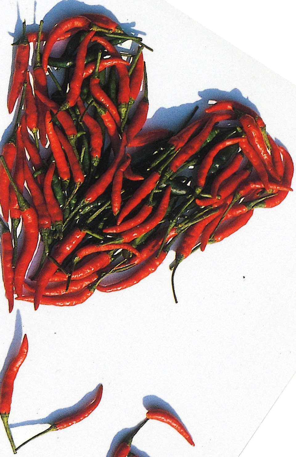

I want to use the "Crop and Straighten Photos" for my scanned files which includes 2 images each.
File>>Automate>>Crop and Straighten Photos
The problem is, for some images this feature doesn't work as it should. Please have a look at attached images down below. I think it's probably Photoshop cannot recognize edges of the images properly as they are not sharp and clear.
Any idea how to fix this problem? I appreciate any help and open to hear any suggestions. Thank you

Both you and the original poster of this old thread should check your scans with the following in mind:
Crop and Straighten Photos is specifically designed to break apart a scan containing multiple small photo prints. It looks for the white background space between prints.
This can fail when the original scan looks a little different than what Crop and Straighten Photos is expecting. For example, look at the scan attached to the original post that started this thread. They said they expect to get two images. But Crop and Straighten Photos is probably confused because the top image of the peppers does not have a distinct single border against the background (so it might think the peppers at the bottom are a separate picture), and the bottom image is actually a grid of squares with white space between them (it might think those are all supposed to be separate pictures).

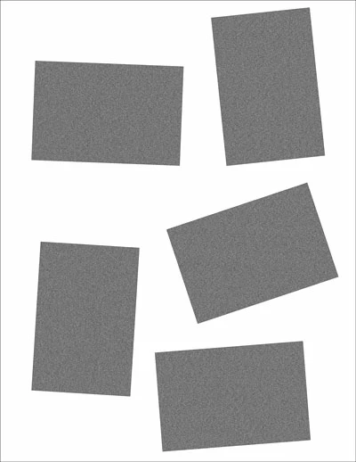

Below is a rough example of a scan that would work great with Crop and Straighten Photos: The prints are very distinct rectangles, and the background is a very clean and solid white. Crop and Straighten Photos can easily split this into five separate perfectly cropped documents. How similar is your scan compared to this example?

My scans are very similar to your example. I ended up finding the solution for my situation in another thread. I had to crop out a thin line all around the border of the scan because supposedly there's some kind of nearly invisible line that throws off the "Crop & Straighten" feature. Once I did that, the scans were correctly split up into multiple files.
