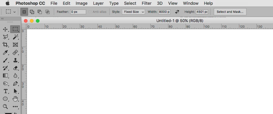

    Hi Andrew,
    My take on your question is that you need the exact same size crop box on multiple images?
    Try using the Rectangular Marquee tool, followed by Edit > Crop. With the Marquee tool selected, you can specify the width and height of the selection in the Options Bar, and you can save the settings with a Tool Preset that will be available in any file.
    ~Barb

    Barb BinderCommunity ExpertCorrect answer
    June 29, 2019
    Hi Andrew,
    ~Barb

    c.pfaffenbichler
    June 29, 2019
    BarbBinder spoke about the
    which can be set to a fixed size in pixels.
