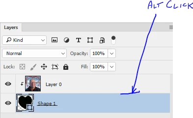

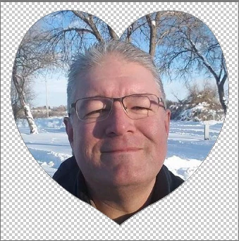

    Quick way
    Put your filled custom shape as the bottom layer
    Put your image above it
    In the layers panel Alt Click on the border between the two layers , so that a small sown arrow appears and the image is clipped to the shape
    You can use Save for Web to export as a PNG with transparency
    Dave

    Quick way
    Dave
