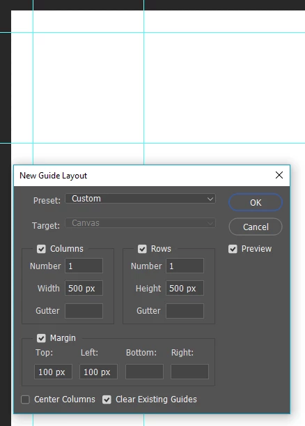

I have a long winded workaround you could maybe assign some of to an action.
Make a new Guide layout like so.  The settings will remain unless changed, or you could save it as a preset, and/or make it an action.
With Snap turned on, drag out a selection which will snap to the guides.

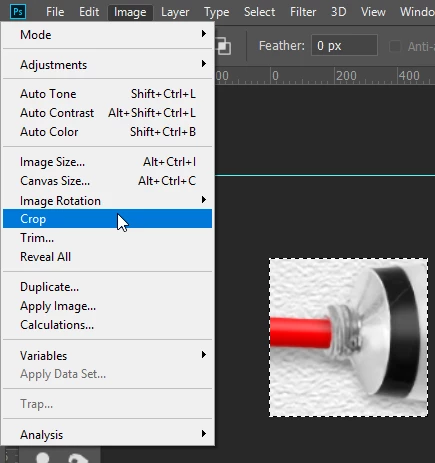

With any selection tool selected, drag your selection to the required crop area
...and go Image Crop
