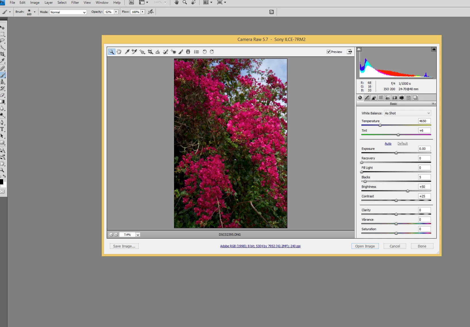

    Thank you both for the helpful information. I updated the camera raw using the link R_Kelly sent and immediately the preview images show up in Bridge and open with Camera Raw. Thank you! And thank you Terri for all the scrrenshots and info for another workaround! So helpful!
    Success!
    Terri Stevens
    December 10, 2016
    very glad to hear that it is now working for you. There is not any great disadvantages to using the converter apart from the fact it takes a little time to work. On my system it did 3 conversions in batch mode in 45 seconds, so 15 minutes to do 60 exposures which isn't too bad.
