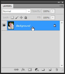

    >1. Make the image a layer (not Background).
    To do this, make the LAYERS panel visible, hold down the Alt key, and double-click the Background.  It should become Layer 0.  If it is not the Background to start with, you can skip this step.

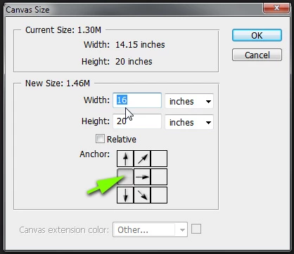

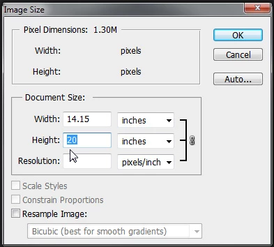

    >2. Increase the canvas size to 16 x 20 ratio, opening new space on the right.
    Image - Image Size, UNcheck Resample Image, and make the image 20 inches tall.  Then Choose Image - Canvas Size, and expand to the right as follows:

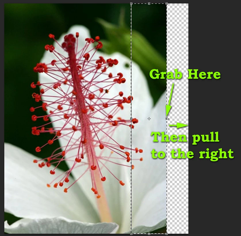

    >3. Do a rectangular selection excluding most of the red parts.
    You should have, at this point, an image with some checkerboard showing on the right side.  Choose the Rectangular Marquee tool as I noted above in post 5 and drag it around the area shown in post 1, including a few of the red parts.
    >4. Edit - Content Aware Scale and drag the right edge handle to fill the canvas.
    Click Edit - Content Aware Scale from the menu.  You'll get a set of little square handles all around the portion of the image that you selected.  Grab the one at the right edge and pull to the right, as shown here:

    One problem was that the "Relative" box was checked in the Canvas Size.
