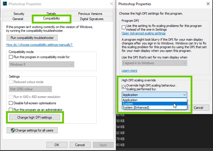

    If your on Windows 10 try right clicking on the Photoshop.exe or shortcut and select properties and select these options

    I've had this problem several times and found two fixes. First, it is a DPI problem. There is a conflict between your Operating System, the Specific Program and your Monitor Capabilities.
    1. The use of Manifest files - https://danantonielli.com/adobe-app-scaling-on-high-dpi-displays-fix/ . Unfortunately, these work with various levels of success across CS6 I use and/or other programs.
    2.  Working with program Properties. Recently I moved to Windows 11 and a whole lot of programs began having this problem. This was my solution across several programs.
    Menu Bar Tiny Scaling
    This is NOT for the Windows Taskbar. It’s for other program menu bars. If the menu bar in a program is tiny, the fix is multi-stepped, but easy.
    1. Find the program start icon, not the shortcut.
    2. Right click on the icon and select Properties.
    3. Click on the Compatibility tab.
    4. Check mark the box “Run this program as an administrator”. This isn’t require, but usually a good long term idea.
    5. Click on the bar “Change high DPI settings”.
    6. Check mark the top box, “Use this setting to fix...”
    7. Under Use the DPI that’s set...” click on the bar and select “I open this program”.
    8. Check mark the box “Overrode high DPI scaling behavior,...”
    9. Select either “System” or “System (Enhanced)”.
    10. Click on the bar, “Change settings for all users”.
    11. Click OK to close the window, then click OK or Apply to close the dialogue box.
    Hopefully, I'll be too old and die before I have to go through this again. 🙂

    Here's the answer:
    Right click on the shortcut folder to the Lightroom or Adobe file that you're having issues with
    Click on Properties
    Click on Compatibility
    Click on Override high DPI Scaling performed by....
    Click on System
    SOLVED!!!!
