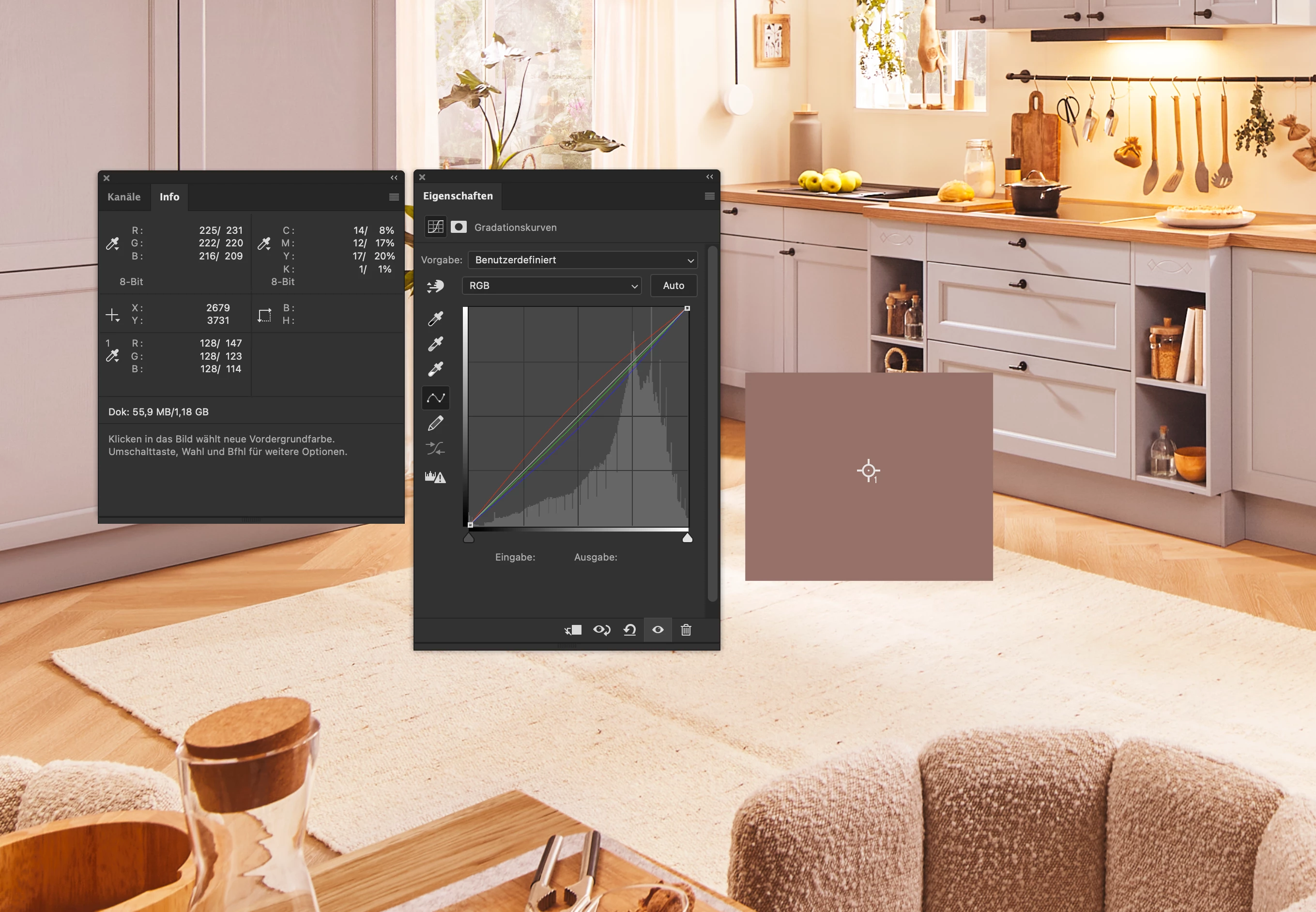

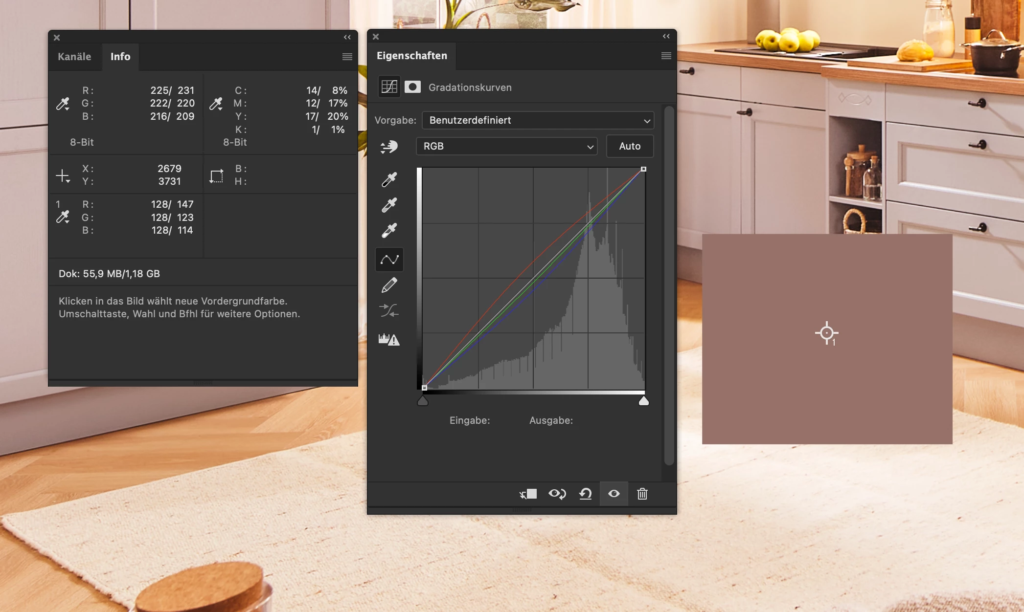

Issue
  • Photoshop version: 26.0.0
  • OS: Max OS Sequoia 15,0
Steps to reproduce:
  1. Fill 50% Grey
  2. Add curves
  3. "Sample in image to set gray point"
Expected result: Neutral. R:128 G:128 B:128
Actual result: R: 147 G: 123 B: 114
Attached you find 2 images. One picture is from the Intel Mac, de RGB values behaviour with Sample in "image to set gray point" tool are not right. We have confirmed this on multiple images with multiple sample points. The second image is from a M3 Max, same Photoshop Version, the result is as expected, neutral.

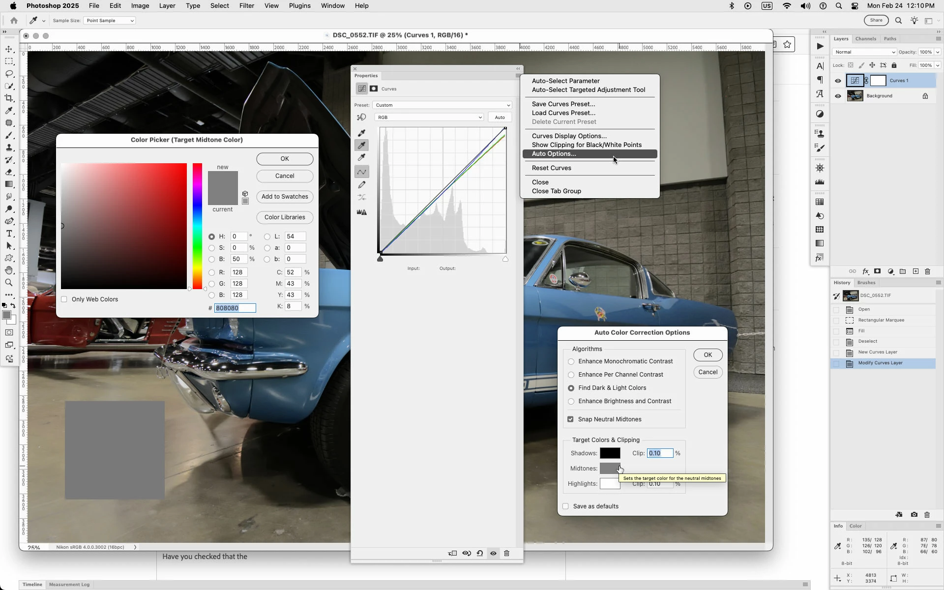

Have you checked that the Target Colors for the Gray Point eyedropper are set to R 128 G 128 B 128?
To do that with the Curves Adjustment layer click on the flyout menu then click Auto Options and click one of the choices other than Enhance Brightness and Contrast in order be able to click on the Midtones color chip

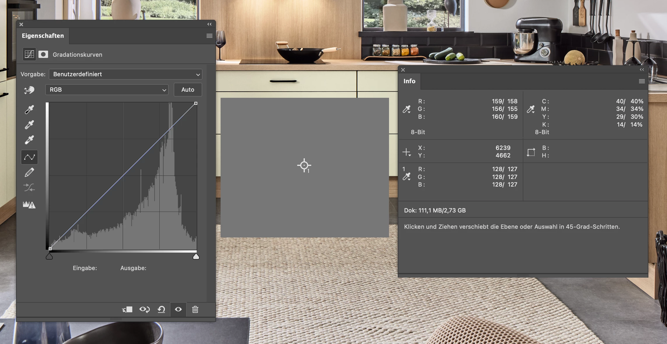

I can't reproduce it. The tonal values of the image are preserved, so you won't necessarily get 128 - but you should get neutral gray R=G=B on the clicked point. I get that here.
This isn't something I normally use, so I may be missing something.
