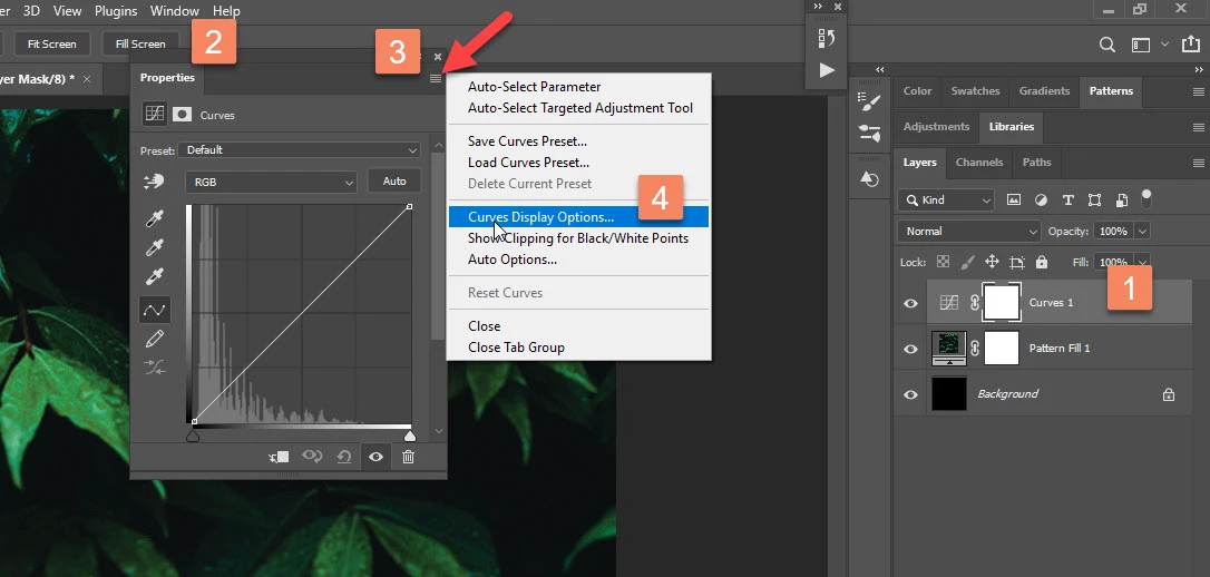

Check that from Properties panel menu > Curves Display Options you have selected Light instead of Pigment, I think that is what you are asking for.
December 14, 2020
I cant see where that option is on the panel. Can you send a screenshot?
Bojan Živković11378569
December 14, 2020
Take a look at screenshot below
