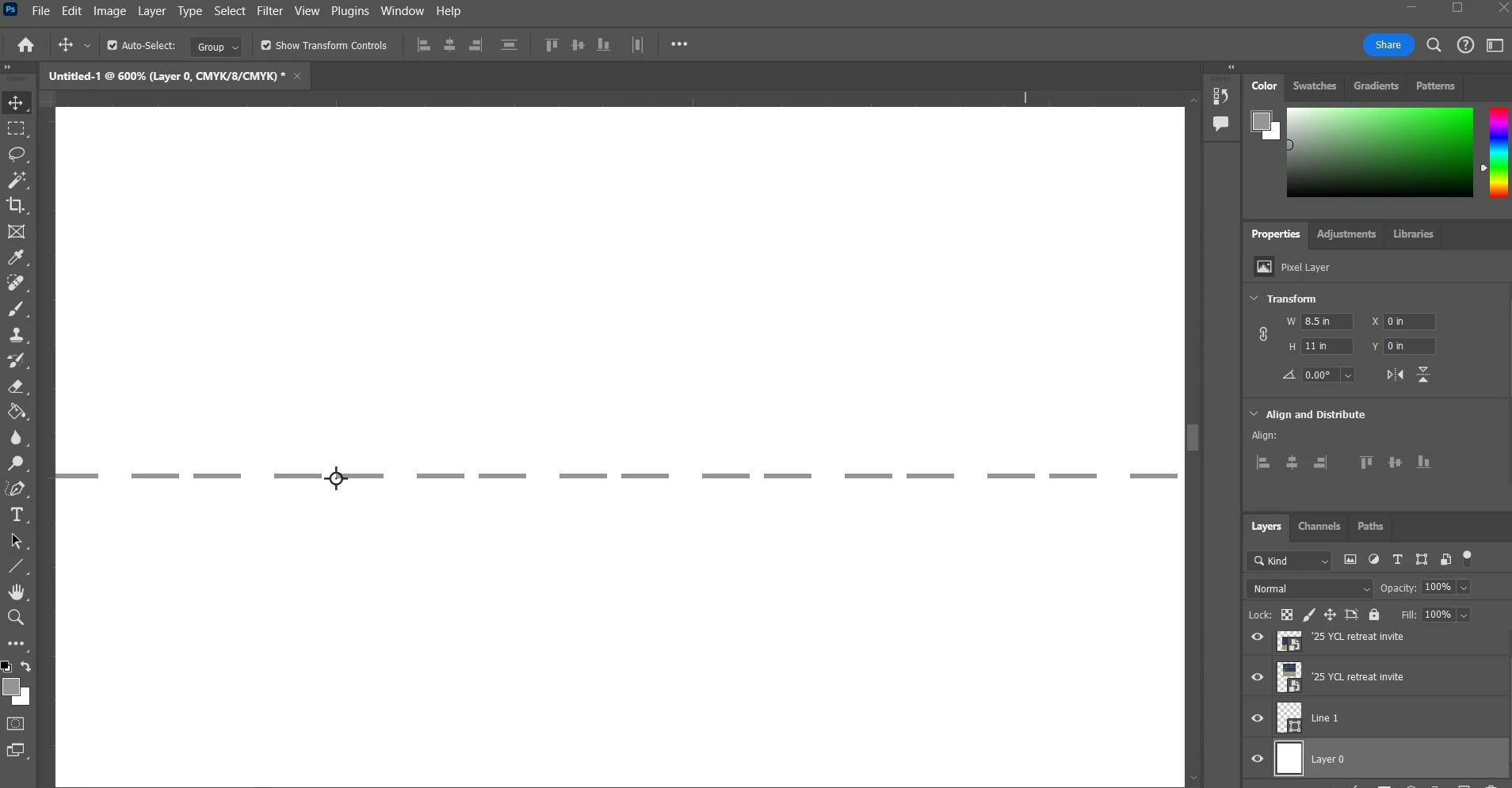

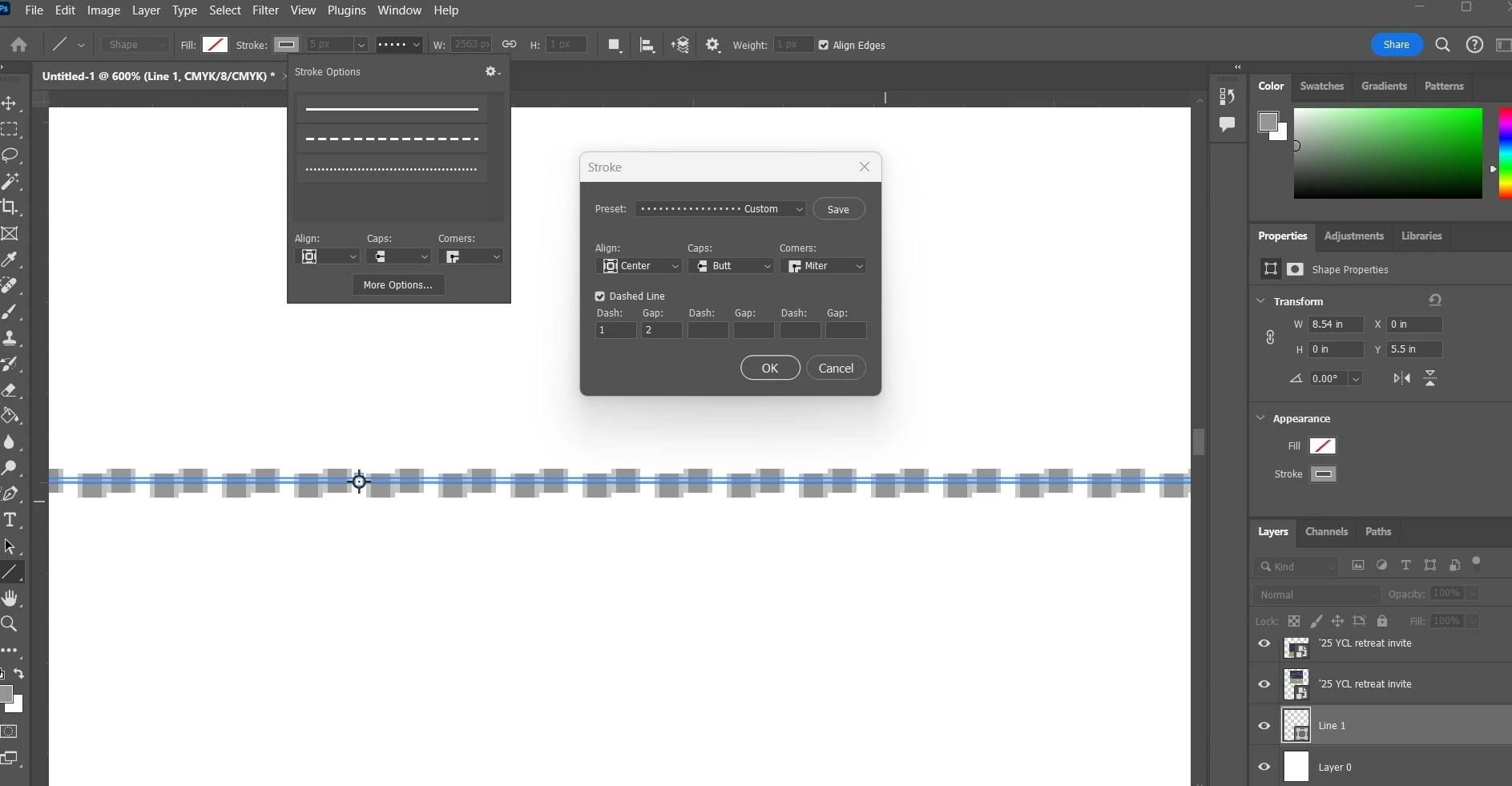

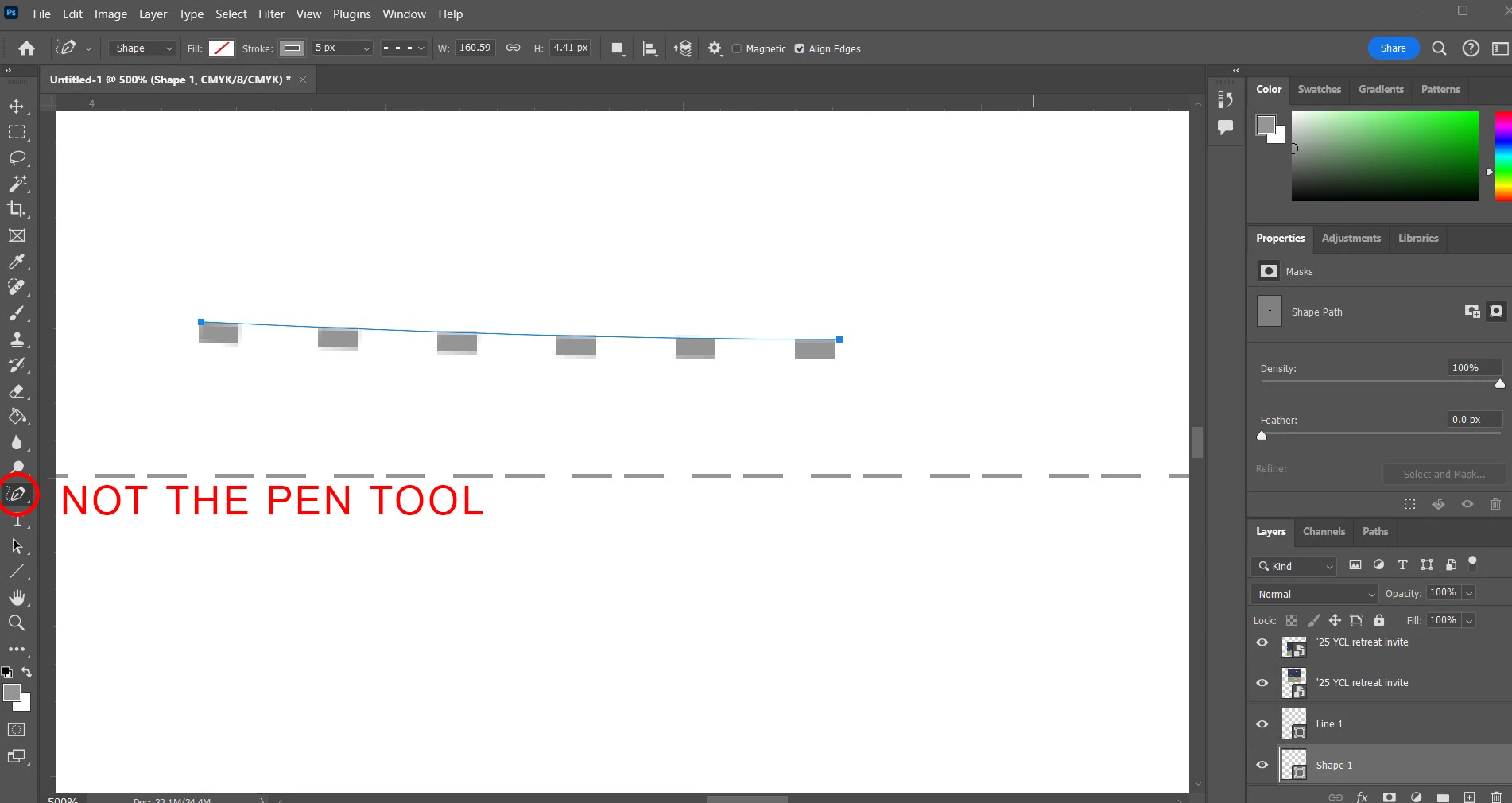

Line tool: When I draw a line, with SHAPE selected, FILL transparent, dashed line chosen, it gives me dashed lines that are somewhat offset and overlapping. See settings and line below.

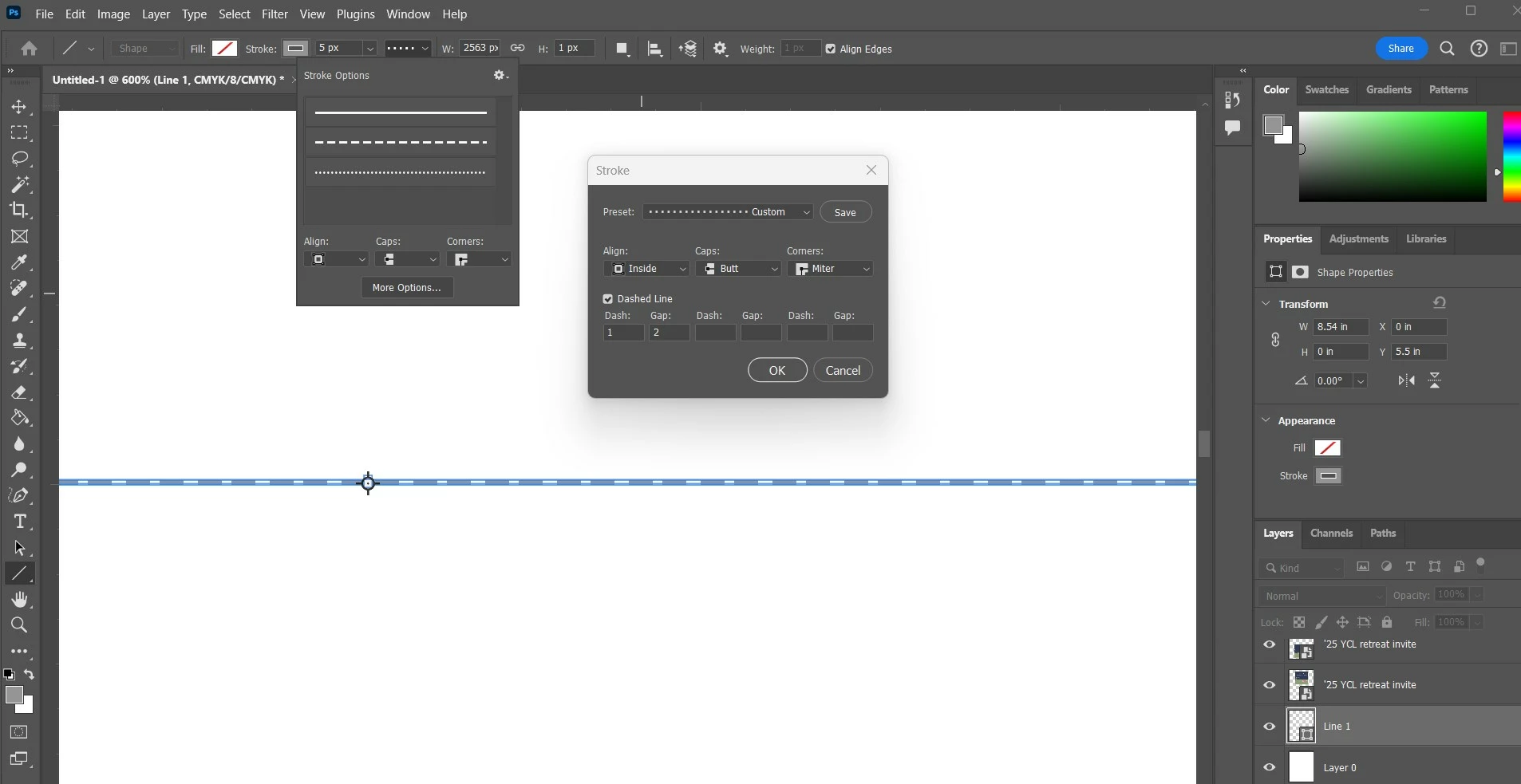

And when I change the alignment to INSIDE, it creates this dashed line with almost like sets of dashes, with a longer gap between each set of two dashes. See below.

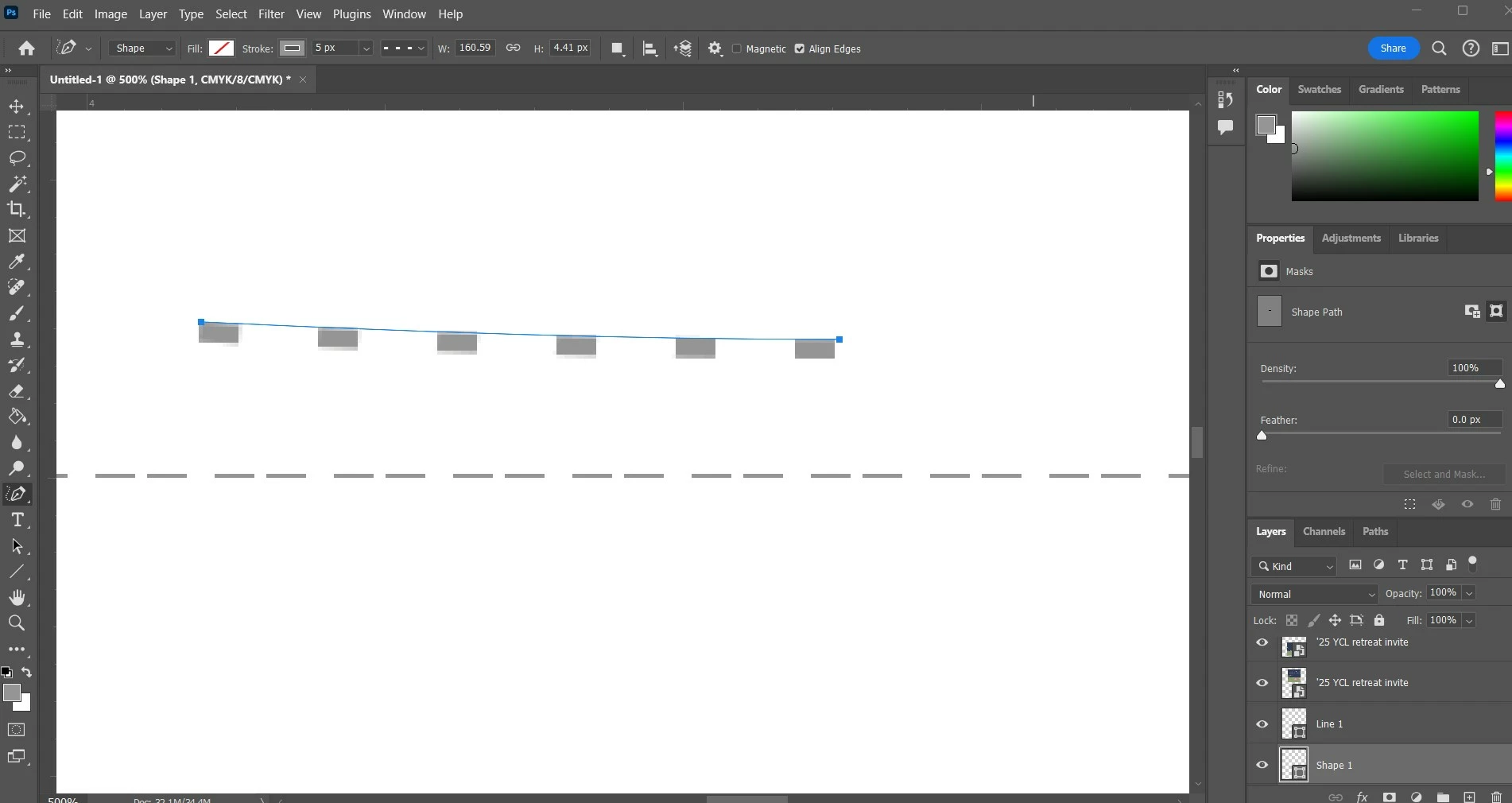

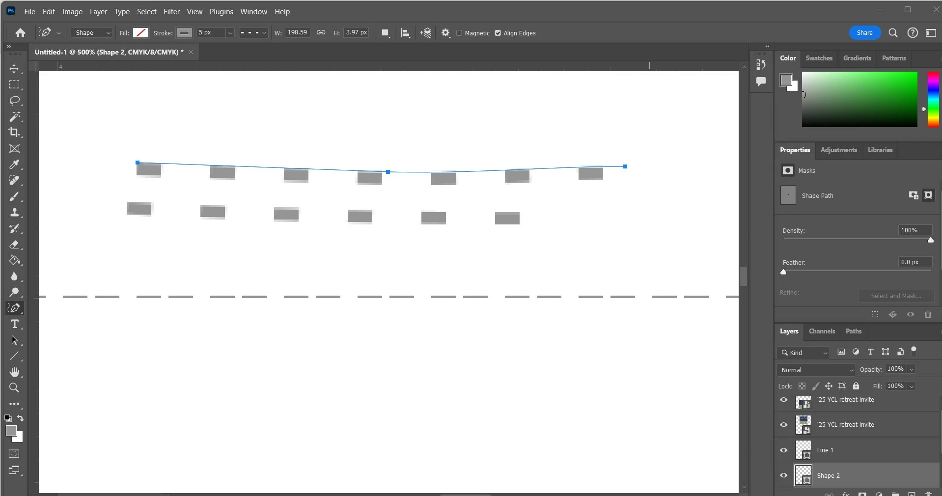

Now for the pen tool (same settings - SHAPE selected, FILL set to transparent): When I click the pen tool, the pen with it's little squiggly line and a tiny empty circle appear, but no anchor point appears. Nothing happens if I try to drop a second anchor point. Then if I click and drag the pen tool, I get a wonky dashed line.
But when I hold shift, then click and drag the pen tool, I don't get a straight dashed line. It still draws a wonky line.
WHY?!?! What is going on?! I've googled, I've watched youtube tutorials about dashed lines and about the pen tool, but when I do what they do, I don't get the same results! Please, someone have an answer for what is happening!

Correct answer c.pfaffenbichler
That’s not the Pen Tool, but the Freeform Pen Tool!

Thanks again! Any idea why center alignment on the line tool is creating those offset lines?
c.pfaffenbichler
December 14, 2024
The Line Tool essentially creates rectangles, so on the long side there are two parallel strokes visible.

Nancy OShea

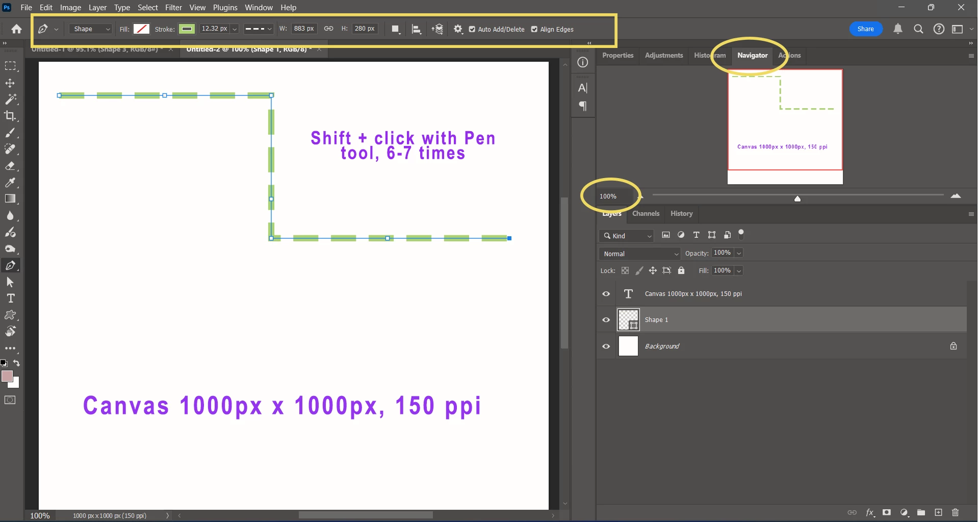

December 13, 2024
File > New >  1000px by 1000px, resolution: 150 ppi.
Set Navigator panel to 100% zoom.
Shift + click with Pen tool to create straight lines.
See screenshot.
Hopefully, you get something similar.
