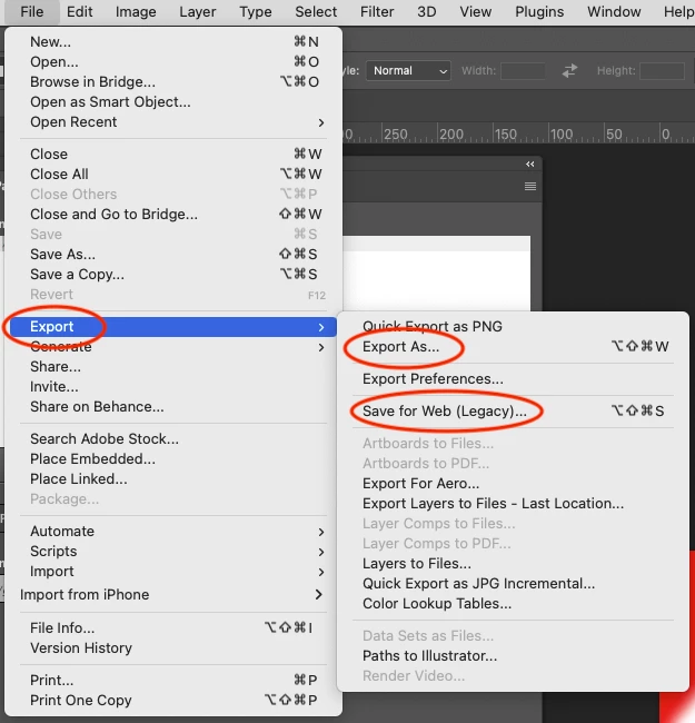

What version of Photoshop are you using?
You should see something like this:
I only have PS CS6.  This is what I see.
