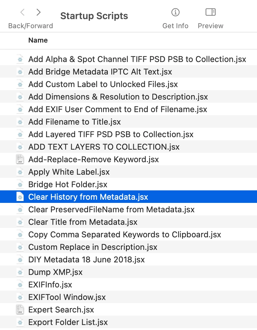

In this example, the script named "Clear History from Metadata.jsx" was saved as a plain-text file (not rich-text) in the Startup Scripts folder:
After restarting Bridge, you should receive a message that a new script has been installed and do you wish to enable the script. I'm not seeing this in Bridge 2024, however, going into preferences I can see that the script is installed and active:
Then select the images and go to the Tools menu:
