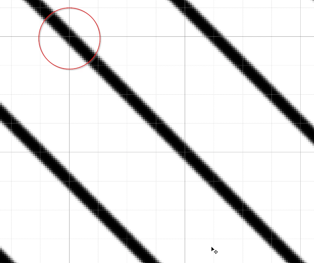

Trevor.Dennis
May 25, 2025 3:12 AM UTC
A way to be more accurate when defining the pattern is to turn on the Grid and zoom well in.
You can then nudge the diagonal lines layer with the cursor keys to exactly intersect the grid.
If Snap is turned on, it is easy to make a perfect selection to crop to.

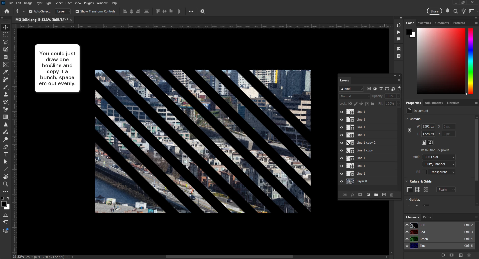

Glenn 8675309
May 24, 2025 1:35 PM UTC
I used the line drawing tool and made the stroke bigger.   Everyone presses and holds a shift to make straight lines, when using a brush.
Using the click and shift method draw a line at any angle, but it might not be 45 degrees.
I might make a set a brushes based upon the diagonal lines you see below.
