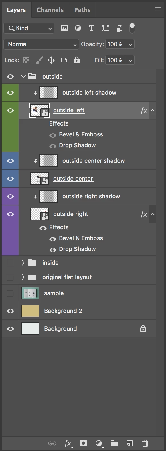

August 7, 2019
Hi Sahil,
I'm using CC 2019 v 20.0.5 and here is my layers panel. Thank you!

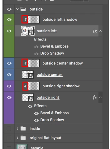

August 7, 2019
Thanks for sharing the screenshot.
The issue might be happening because of clip masking as shown in the image below marked in red:
Try pressing the Alt Key and then click between the layers to remove the Clip mask from the layer you want to edit.
