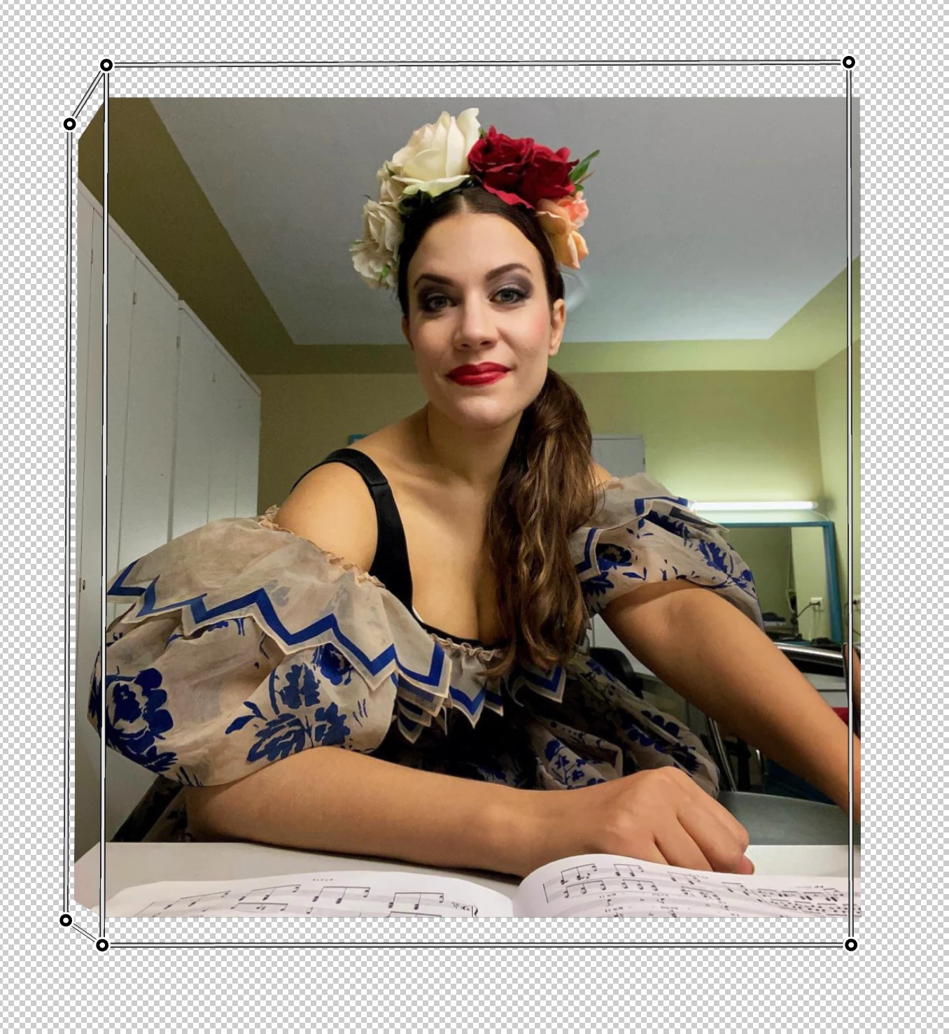

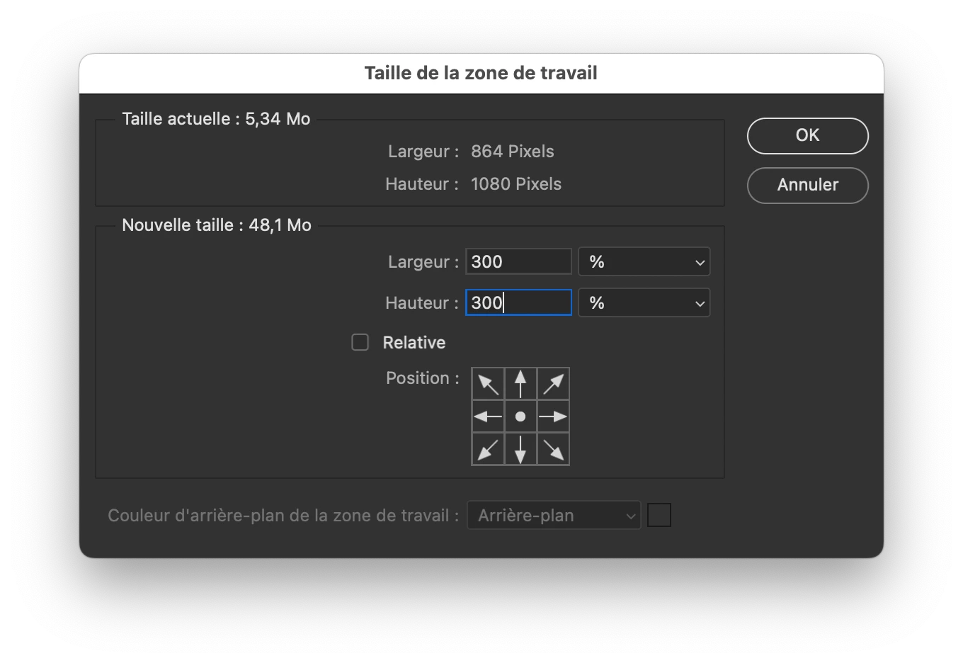

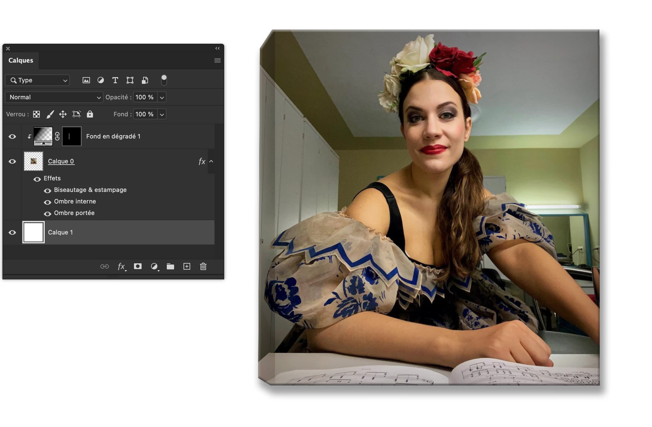

    I tried the following :

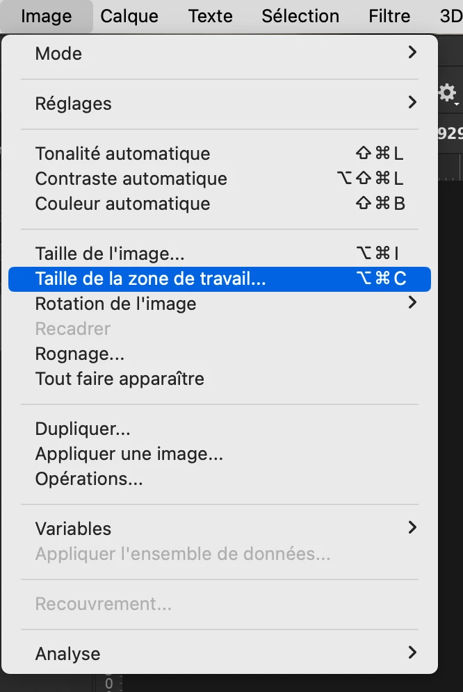

    Enlarge canvas size

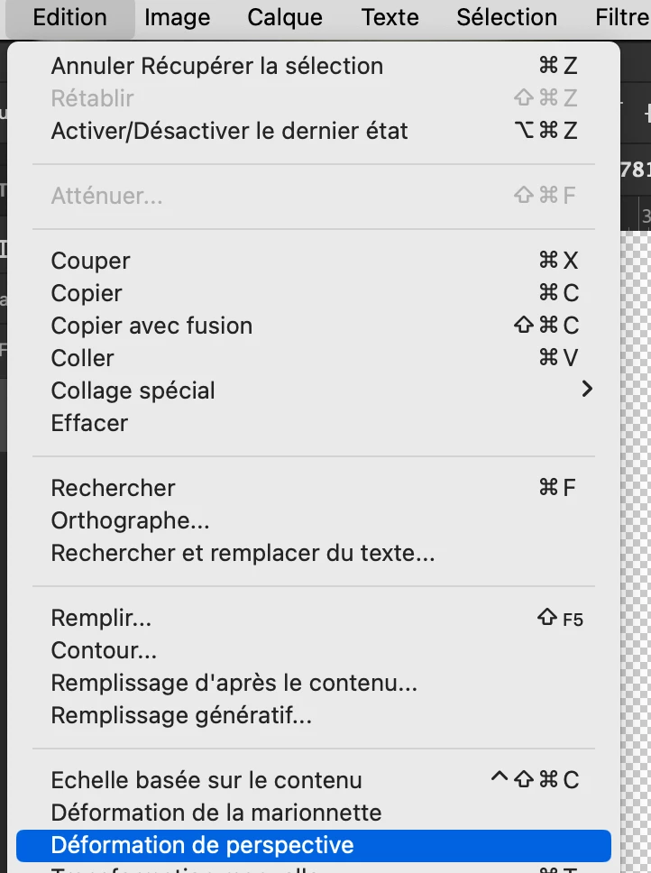

    Perspective distorting

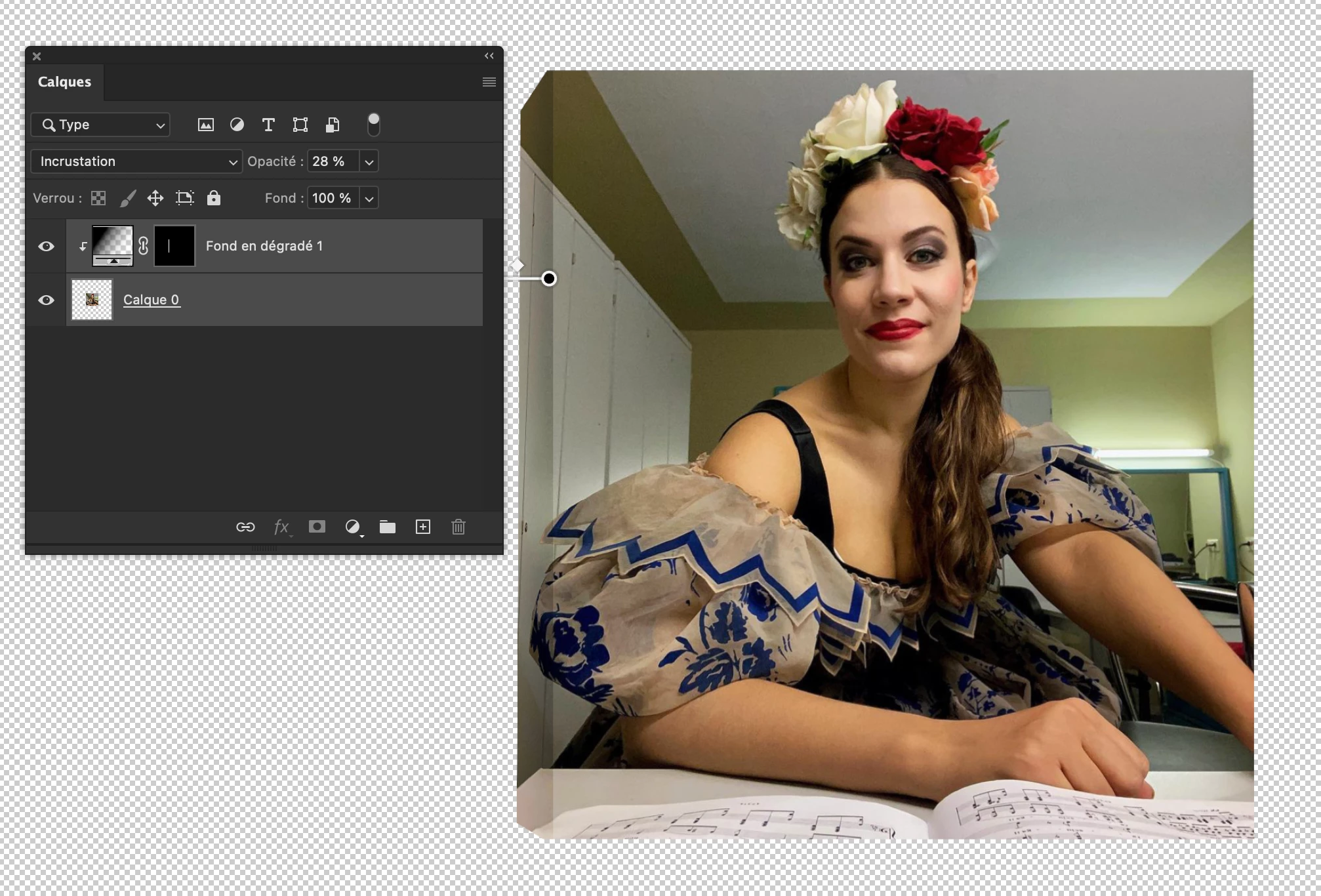

    Adding a gradient to simulate shadow on the side
    A few effects on the layer (smart object)

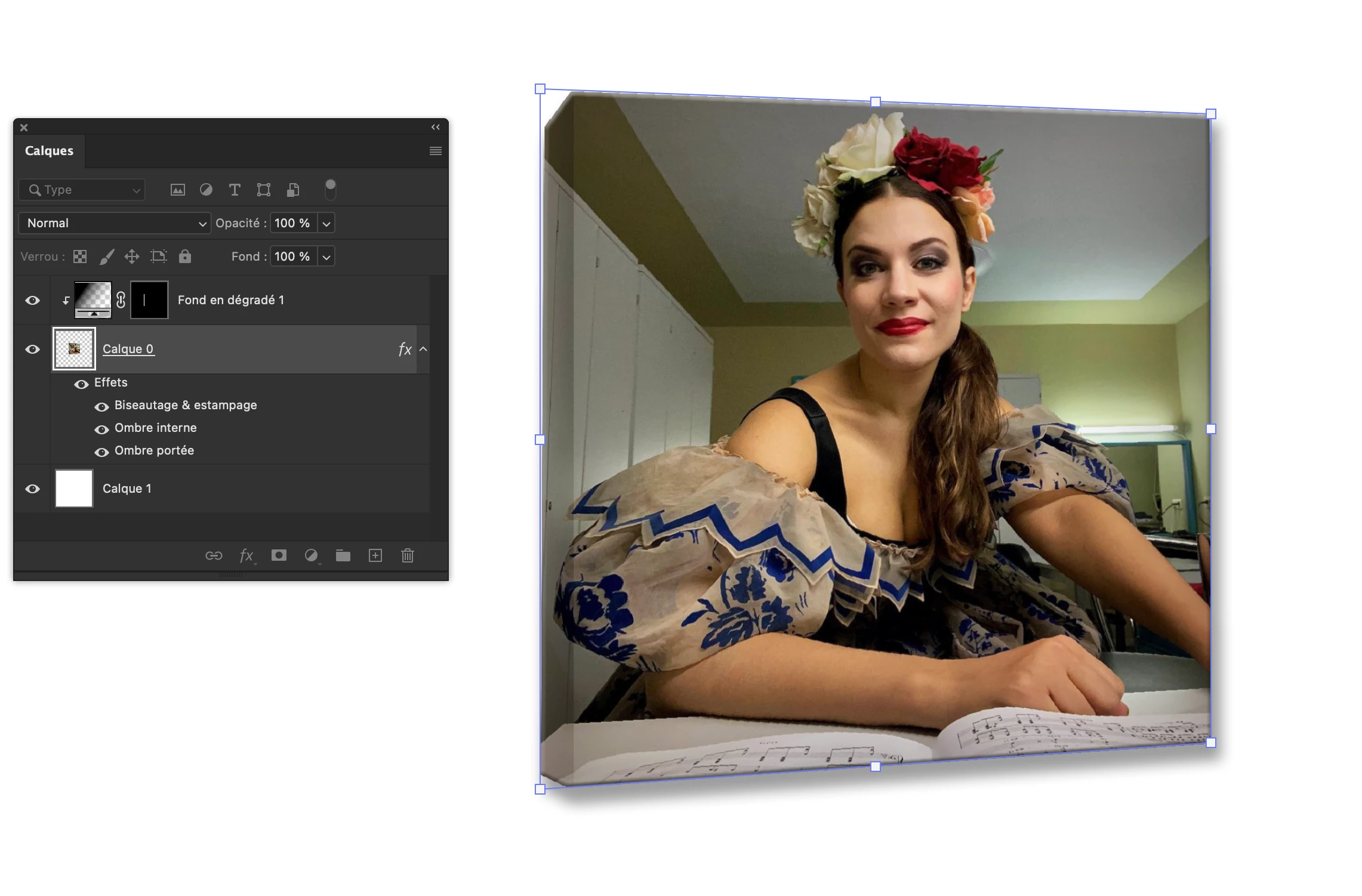

    new bottom white layer : Bevel and emboss + Drop shadow + inside shadow
    A last distort with manual transformation
    Quick and inperfect result but maybe a clue to you
    BTW This person is the extraordinary soprano Franscesca Dotto. Check on YT her performances…
    January 13, 2024
    Thank you so much for your help on this.  I got around to trying to follow you but got lost on the perspective.  You have a bunch of points around your photo I only have the pic selected
    didiermazier
    January 14, 2024
    With the perspective distort, you just have to draw two rectangles that are tied one to another.
    The last distortion is just a simple layer transformation (⌘/+T(MAc) Ctrl + T (PC).
