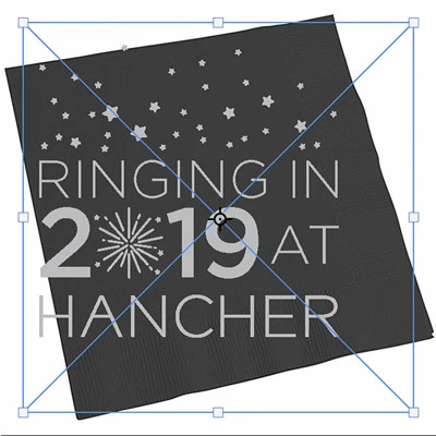

I am aware that you now have to hold down the shift key to preserve aspect ratio. That wasn't the question I was asking. What I want to know is how to pull the corners of a smart object around independently. I used to be able to do this using the Free Transform tool.
To give you a specific example, how would I distort the embedded Illustrator file to fit the napkin. I am able to do it by rasterizing the Illustrator artwork, but I would rather keep it linked if possible.
