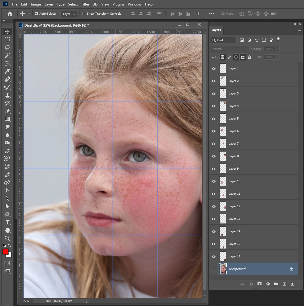

Hi, I'm trying to divide a high res image into 100 separate rectangles, then I need each separate rectangle in its own layer so I can turn them on and off. I've looked at the slice tool but this saves separate images elsewhere. I need to have all divided slices in one file on separate layers. (So when all layers are 'turned on' the image appears normal.)
Is there a way to do this please? Any help appreciated.

A while back I believe Pfaffenbichler posted a script that dices up an image onto layers according to guidelines.  I use his script  in an action that has an interactive New Guide Layout step before the Script step. Its easy to dice up an image that way. Here the script again.

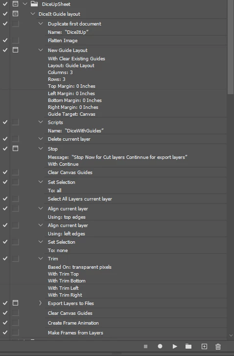

Here is what my Action look like.
JJMack
JJMack
Fenton61Author
October 25, 2021
Thanks for your response. This is rather above my 'pay-grade' as I've never created or run a script before. How do I actually use this complex code? Can I decide how many slices/boxes result? Will they fall into a file registered and aligned in separate layers?
Thanks

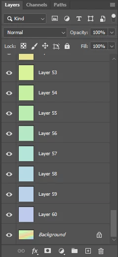

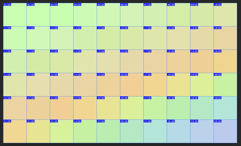

Fenton61Author
October 25, 2021
Thanks for your response. It does indeed load the slices into a file, stacked. But I need them aligned/assembled to make the original image. Also using Image Slice only renders 72dpi files. My search continues....
