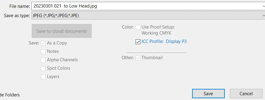

Tele55
Tele55Correct answer
Jan 24, 2023 9:44 PM UTC
Hello Stephen and all,
I think I figured it out.
As I said before, the "copy" does not appear when doing the process manually. But when I used the action "copy"appeared
Solution: when writing/recording the action the checkmark at the tiny box "As a copy" at saving window must be unchecked ... and when later applying the action ... NO "copy" in the file name. (see snapshot)
... even though when running the action it is always checked again, but it doesn't matter ... no "copy"
Another confirmation is to look at the step by step / opened action ... no "with copy" should be there. (see snapshot)
And to confirm again - I have both checked in preferences: File Handling > "Legacy Save As" and "Do not append "copy" ..."
So - uncheck the tiny "As a Copy" when writing the action ... and all is good ... I checked a dozen times
Hope this helps anyone with the same issue.
Cheers
nzharrier
Jul 13, 2023 9:34 AM UTC
I'm using an almost identical action to save as .jpeg. The 'As a Copy' box is greyed out so cannot be unchecked. Always end up with copy appended when running the action.

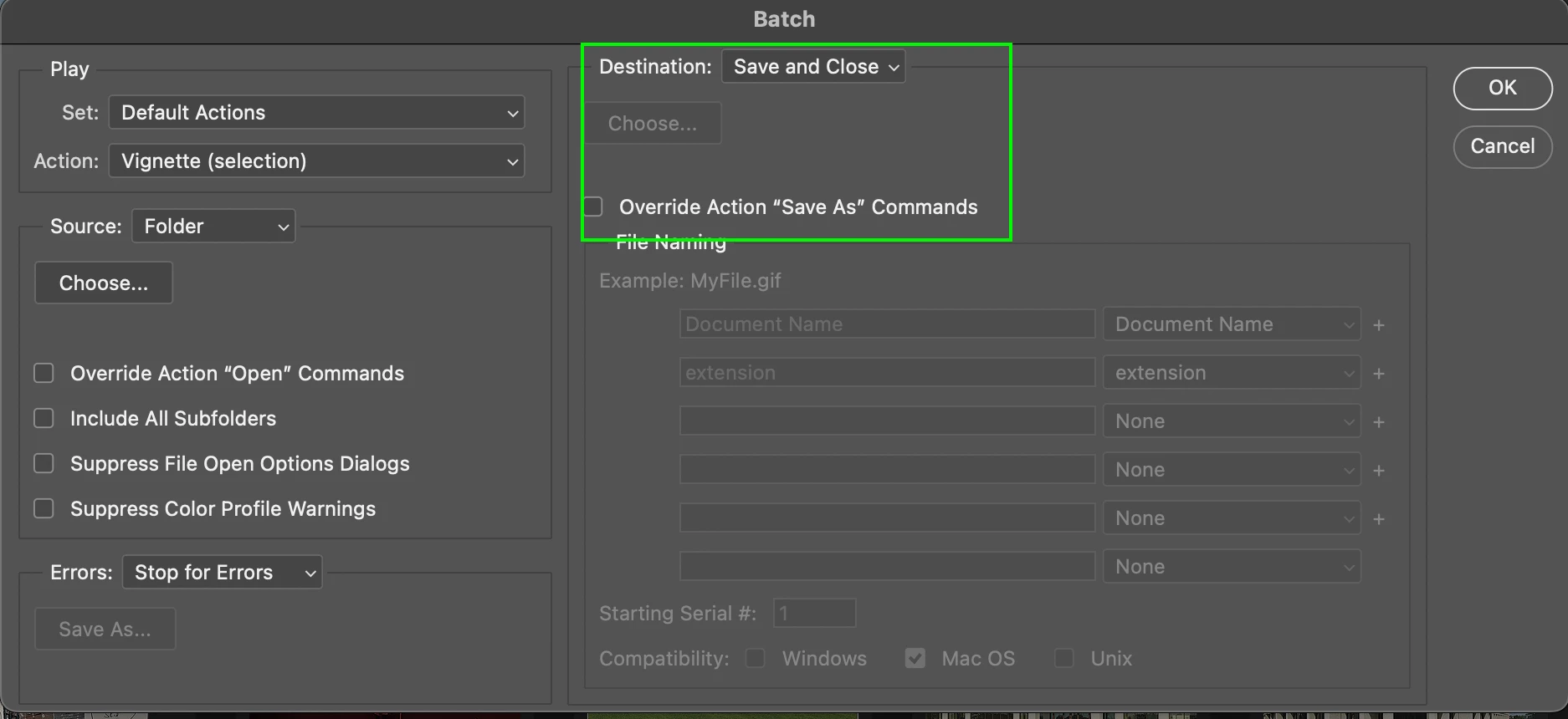

Kevin Stohlmeyer
Jan 24, 2023 3:58 PM UTC
Klaus5F8DAuthor
Jan 24, 2023 4:38 PM UTC
Thanks Kevin,
to explain it better: I want to convert hundreds of jpgs / background removed, into PNGs.
Right now I have to remove the "copy" everytime / time consuming 😞 .... or just live with the "copy" added.
Now, the solution you mentioned in the link is complicated and confusing and I have no experience with scripts.
Unless there is an easier way ...?
Why does an action not reflect exactly what I do manually when I record it?
Is this a bug? It shouldn't be!
Thanks
Kevin Stohlmeyer
Jan 24, 2023 5:15 PM UTC
Are you using the Automate Batch process to accomplish this?
If so you don't need to have "Save" as part of your actions.
Otherwise check your settings to make sure you have supressed and "Save As" features and try again:
