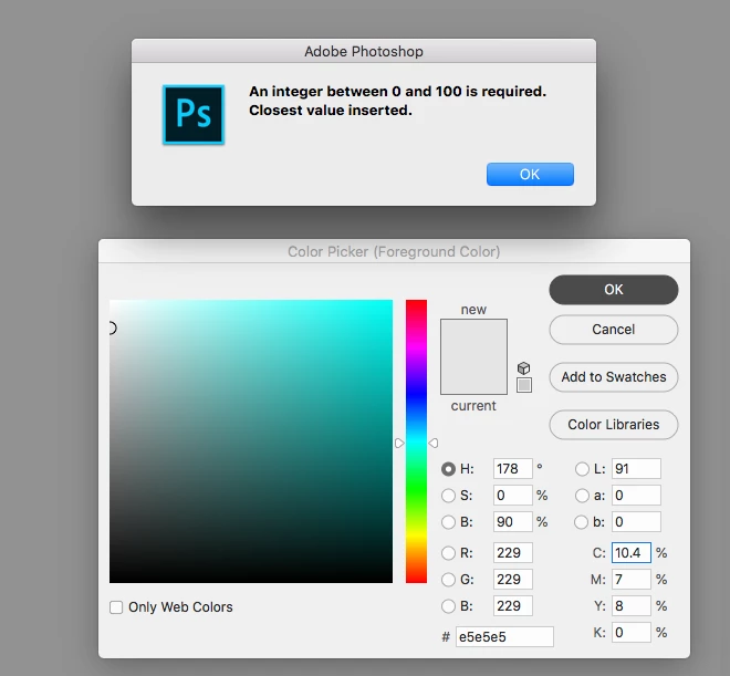

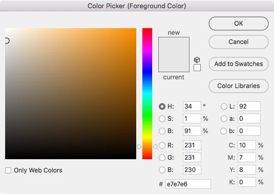

I think one frustration with the Color Picker is that while the RGB fields are 8-bit values, the C,M,Y,K,—S,B, & L are not. So if you are trying to spec a CMYK color in .5 percentages (or get its RGB equivalent) it gets difficult. A typical halftone screen can't be more than 8-bit, but it could define more than 100 gray levels and you might detect that difference in a highlight color.
If I try to enter something other than an integer in a CMYK field I get this warning
My 10.4% gets reset to 10, but the other space conversions change, so obviously the color changed even though I'm still seeing 10%C.
It would be better (at least for offset print work) if the CMYK percentage rounding wasn't to the nearest integer but to the nearest number.

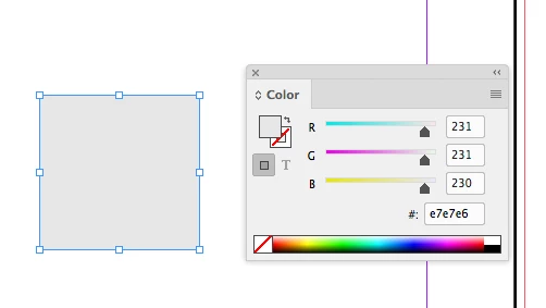

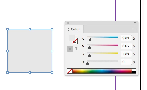

InDesign does conversion rounding to 100ths

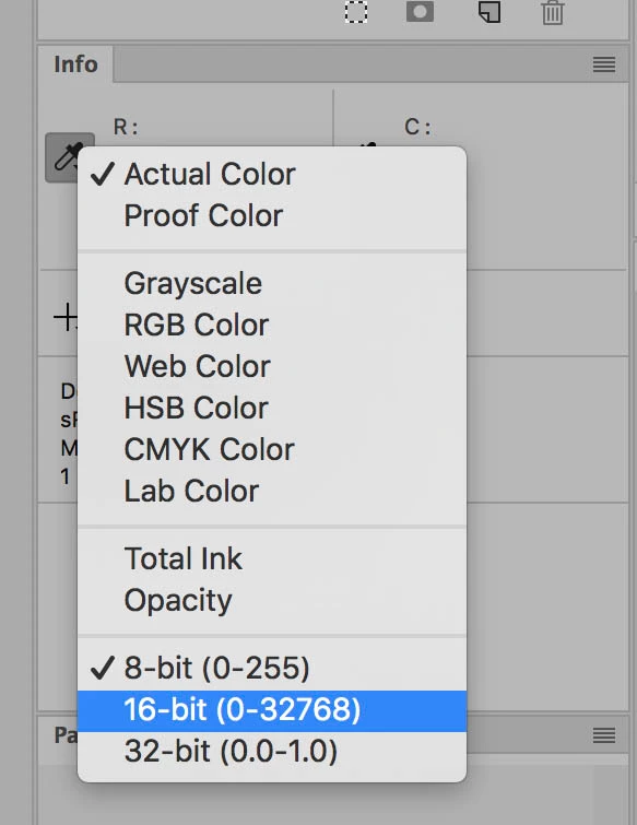

I was aware you could do it in the info panel, but I just find it confusing why the Color Picker doesn't show the true values? I mean why not? Seeing 8-bit values kind of makes me question whether I'm truly in 16-bit mode and if everything is working properly.

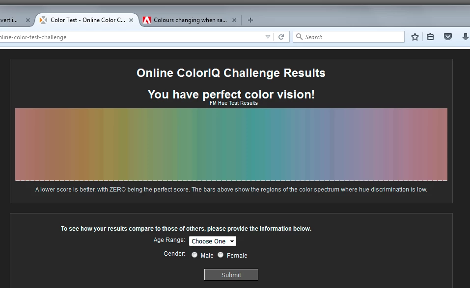

Try this one to give you a little perspective:
Free Online Color Challenge and Hue Test; X-Rite
I managed a perfect score on my second try, a fact I take some pride in because only a few % manage that. The first attempt gave two errors.

Click on the eyedropper icon in the Info Panel and set it to 16-bit.
